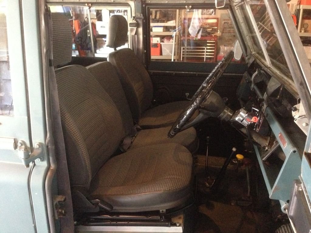

- it only had front static seat belts (and this is a factory 12-seater) so I sourced some inertia reel three point seat belts for front and middle seats (the rear jump seats even got treated to lap belts).
- the seats... well... just trashed. Typical ripped and duct tape fixes. As this was to be my family daily driver, I had to do better. I sourced a good set of front and middle Moorland seats from an early 110. Boy, what a difference those made in comfort (and still fully functional with access to front seat box and middle seat folding). Later, I was fortunate to locate a set of hi-back Moorland seat backs for the middle row. Much safer.

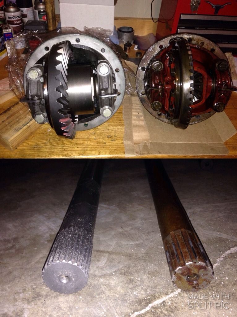

- and the rear diff/axles... well... I'll admit this was a total splurge. I upgraded the 2-pin diff and 10-spline setup to a GBR 24-spline with TrueTrac & thick cut 7/33 4.71 ring and pinion and GBR 24-spline axles. I'm proactive when it comes to the Rover rear end. I like the ease of working with Rover 3rd members so I chose this over the Salisbury swap.
