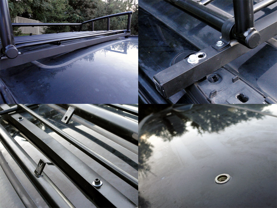

Here's a few pics of the roof rack mounting details. The rivet nuts set in with no problems... surprisingly they don't even whistle when going down the interstate. Everything is as close to the roof as possible to keep wind resistance down.

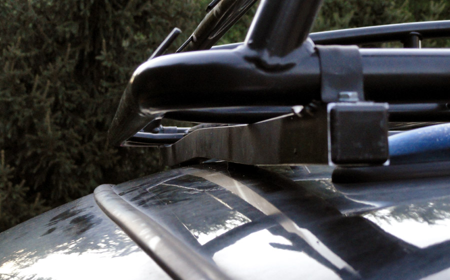

Bent the front load bar to follow the roof curvature as best as possible... all to get the rack prob 1/4" lower. A couple small neoprene washers go between the rack and the roof.
Front wind faring on:
