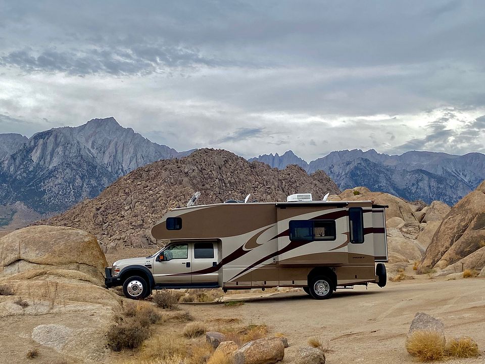

So I read up on rear track bars and because I could not find a kit available I decided to make my own. I bought a adjustable track bar and grade 8 bolts from tractor supply and got some metal for brackets.
brackets are welded in one on the frame and one directly to the rear axle housing.
I set the airbags to my normal ride pressure and adjusted the bar length to fit the welded brackets and bolted it down. All in all it was super cheap like $34 and a kit like this (Bolt On) for a Chevy chassis is like $760 lol. My kit actually has a longer bar then a bolt on kit would so I think incase of any unlikely case of big suspension flex it wont push the axle to the side as much as a shorter kit would.
So this did not totally fix my rear waging tale problem but it does help for sure. My next step is upgrading the leaf springs. According to ford dealer who searched my vin number my stock leaf springs 5400 pound are almost maxed out and with out any air in airbags are always sitting on the helper springs (stock helper springs are 1300 pounds of help). Having an F450 only one leaf spring available from factory for the F550 cab and chassis 3 different weight leaf springs available and from my research they are all bolt on. I am thinking to go from 5400 pound spring to to 5900 pound spring and that should give me the extra 1000 pounds left over. will see. rear axle comes in at 10,800 LB

1. 2014 according to the door sticker
2. about 3 inches that all u need to fit 40's but i do need to cut the fender and bumper a bit
3. still stock gear ratio what ever comes on Cab and chassis i think there is only 1 or maybe 2 different once i don't remember what it is. Drives fine i dont feel under powered but then i am on vacation when i drive it so i am in no hurry. if i need to pass its no problem
Track bar from tractor supply its a local store. I believe u can buy it on their website too.

Your rear axle looks to be the 10lug S110 which under the F550 CC would be a 4.88 ratio with a LS.
Im assuming your front is the Wide D60 10 lug. Did you just add spacers? or was your front hub an 8lug originally?

It was originally 10 lug S110 rear and wide front axle I used 10x225 to 10x285 adapters for these wheels.
