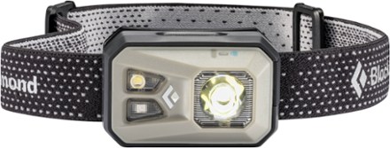

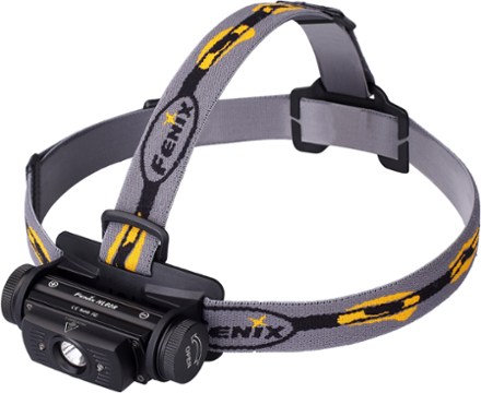

Headlamps:
2 of these (flood light ) when working on stuff...batteries on high last 5-6 hours then have to be recharged overnight
1 of these to light up the trail. - not well balanced front to back. Gets my forehead warm and only lasts 48min on high. - red light is useless.
1 of these - good (if you don't mind small buttons) rechargeable. Will also use NiCad and Alkaline.
1 of these - great - stretch the coiled wire or it will keep pulling off to the side. Hits all the marks except it can only be recharged when the battery is dead.
