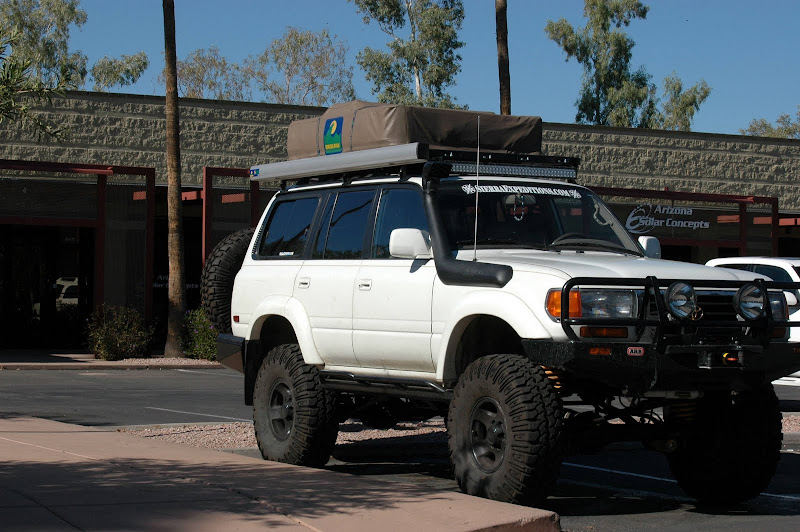

Ok rack is on...
Here you can see the clearance of the Front Runner airdam vs sunroof in the vent position.
With the tall feet the Rack clears the OEM rack.... however one of the OEM crossbars must be removed to fit the table.
Here is the Rigid Industries 40" E Series LED Bar Mounted using the U Cradle and 4 Frontrunner Light Brackets.
Now to remove the 2nd OEM cross Bar and wire in the LED Lights.
