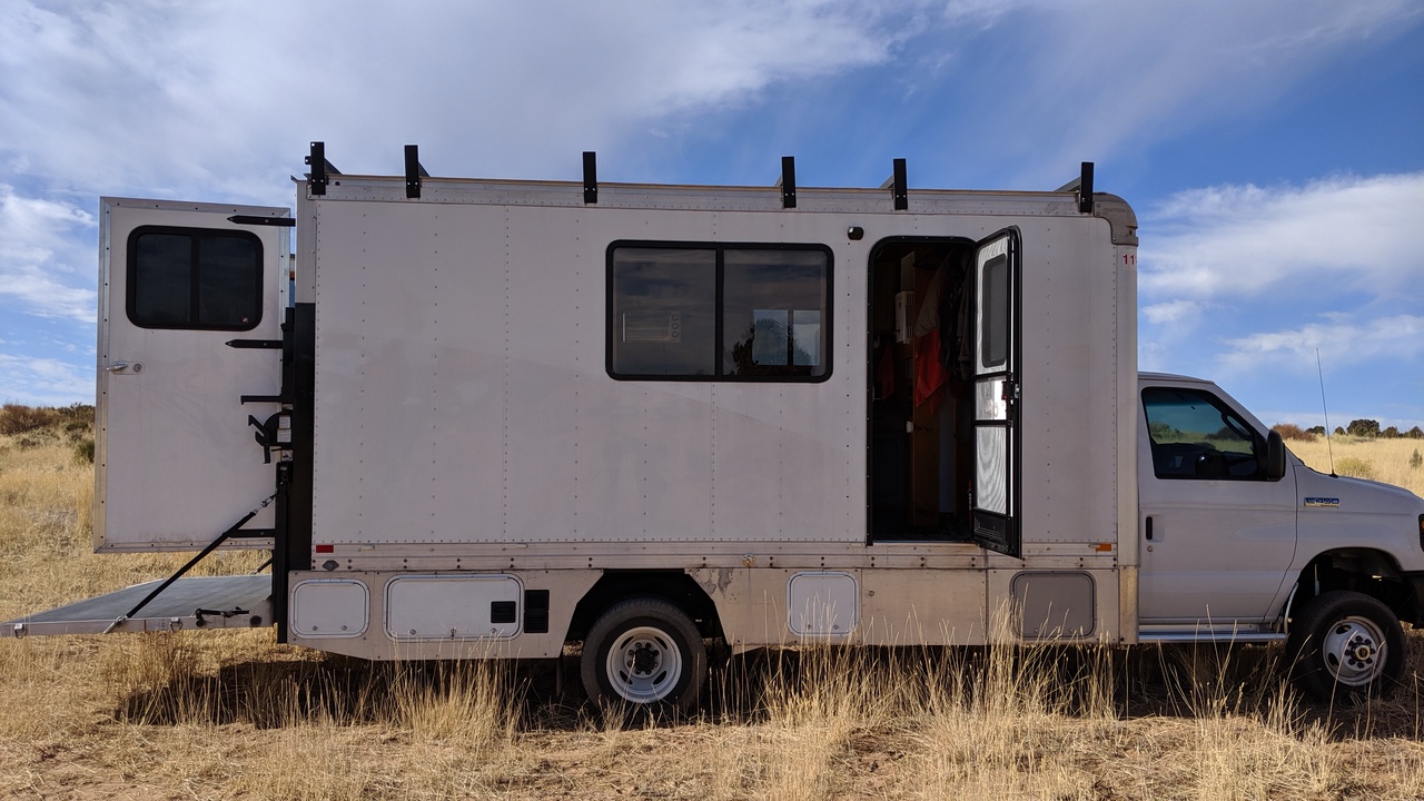

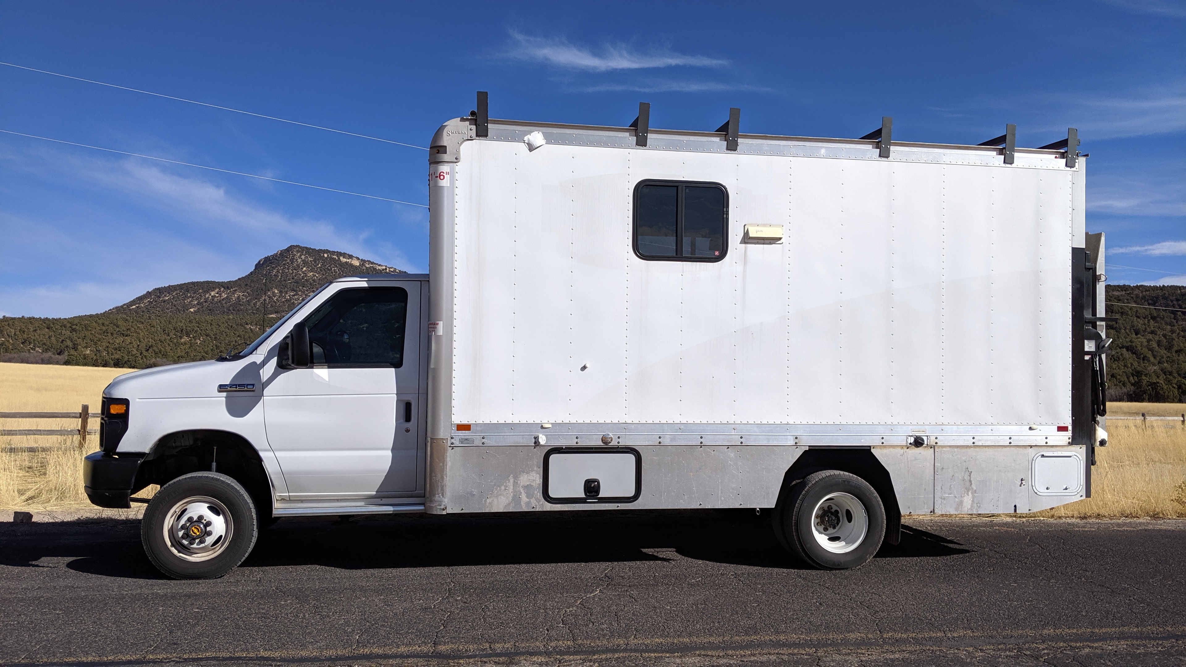

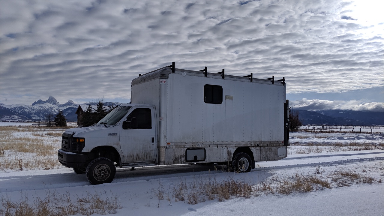

Hello, I built this rig to ski and explore the western mountains. It has the V10 engine, 36,000 miles.
Still under Ford factory warranty.....
The coach build was done in 2019.

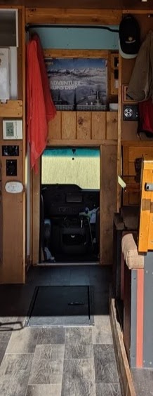

PASS THROUGH Door from cab to coach.
Some of the features..
**levelers** Equalizer brand and installed at the factory.
Diesel coach heat with custom 9 gal tank. ** Dec 7 th in Granite Falls WY...8degs in the am, we burned about .75gal in 14hrs.**

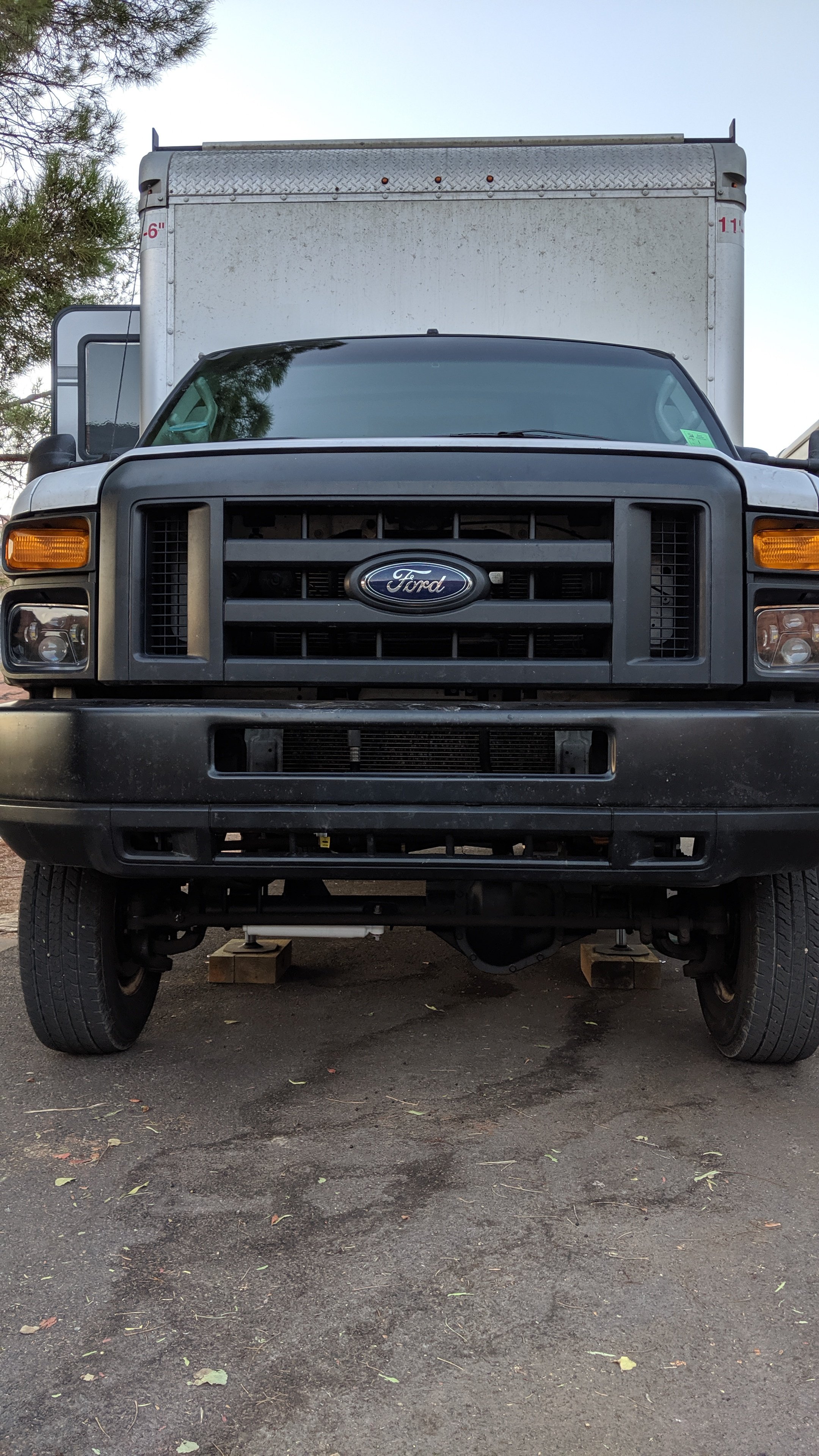

**4x4** conversion by Advanced Four wheel drive. High and low range. Lever is beside drivers seat.
Manual locking warn hubs.
Propane 2 burner propane stove.

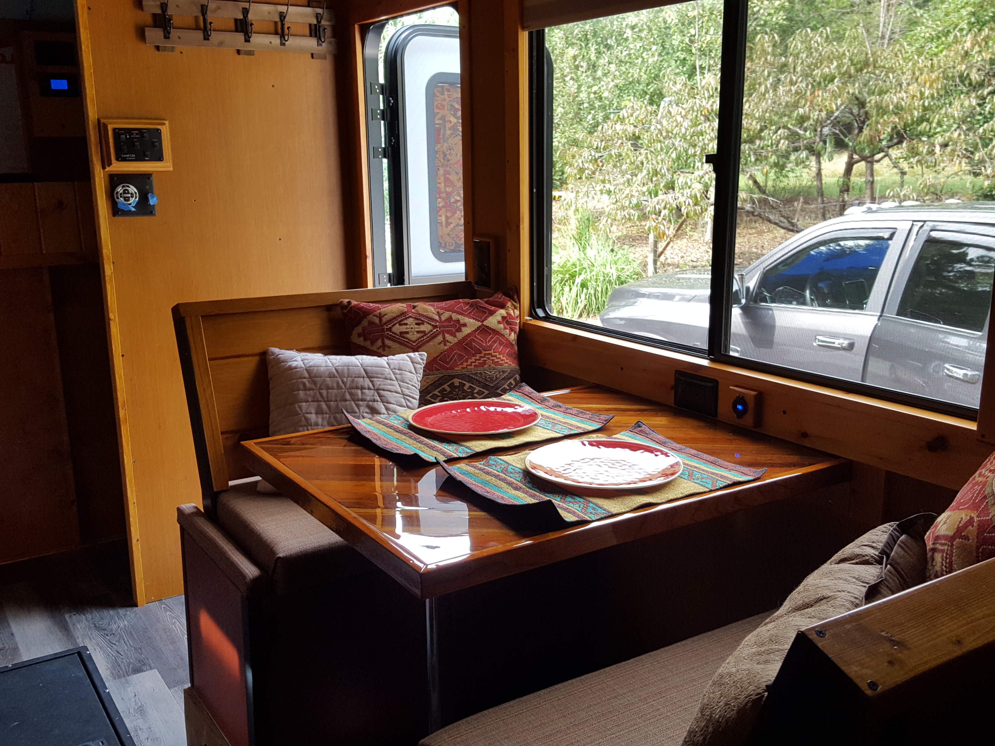

Custom built dinette table with 5 types of wood.
The table and bench seats are built on top of a 7" raised platform. This contains 5 pairs of snow skis.
Natures head toilet. Very pleased and would install 1 again. Black tank....... forget about it.
SO MANY similar rvs, van builds etc. use a cassette toilet. We heard a lot of complaints on the frequency of having to dump and the smell.

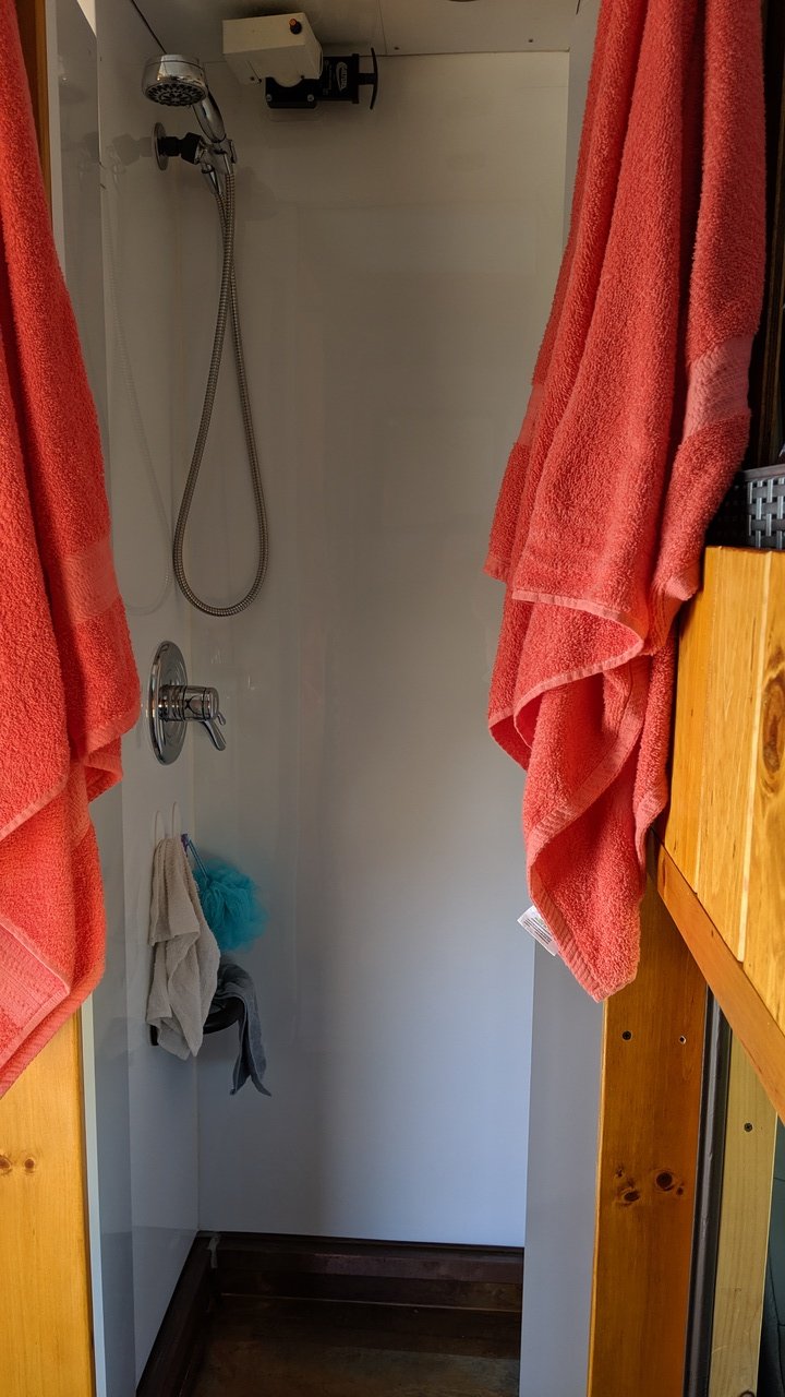

**Dedicated shower**. Not a wet bath where you get water all over everything....it's a shower stall with copper pan.
Round and deep stainless kitchen sink. Pull out spray wand on faucet.
All plumbing is pex with brass fittings. Except going to the pump from tank.
Water line goes straight up into coach from the insulated and heated water bay.. the 12v pump and all remaining lines are located in the coach. Kitchen sink and shower are back to back.
Both water lines have dump valves for quick drainage. There is only about 10ft of pex for the entire water system.
Unique and simple design for only 1 J trap for sink and shower. Plus the J can be removed and reinstalled quickly should freezing accure.
Domestic Fridge 12v and 120v
33 gal fresh and 33 gal gray water tanks.
Thermaheat.. heating pads on both tanks. They maintained 41 degrees with outside temp at 2 degrees.
This tank bay is also spray foamed then the tanks have 1/2" tuff-r ridge foam against them on 4 sides.
SO... I have **FULL** use of my water system for sink and shower... AT 0 degrees.
Propane ventless and tankless water heater. Works like a champ.
I don't heat nor maintain hot water unless I need hot water.
We use about 1lb of propane a month for cooking and showers.
Insulation .. Spray foam was professionally installed, Walls R-16+. Ceiling R- 25+. The foam is amazing, the r value is way above hard board or bat ins. **NO air leaks**.
Insulation .. floor is 1" Tuff-R- @8.
Generator - Cummins/Owan 2800 Gasoline fueled from Main fuel tank.
Hard wired and mounted EMS for incoming 120v.
Wired for roof top ac.
Aluminum roof rack system installed for addition of solar, kaiaks, etc.
Automatic transfer switches from gen or shore power.
Therma-pane windows with screens. These are an upgrade from 70% of rvs out there.
Bed is a queen and is raised and lowered via a 12v winch. 1x4 slats underneath let the mattress breath.
Convection oven 120v.
2 in floor aluminum storage boxes 23" x 23" x 13" deep.
Bilstein shocks..blah, blah, the list goes on..

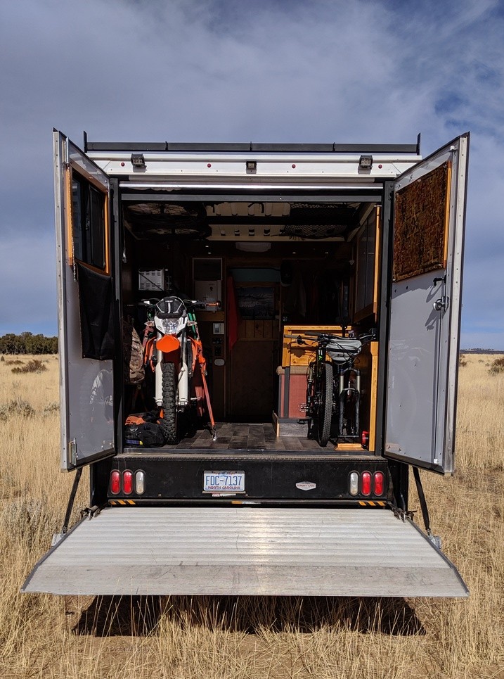

Inside storage..... built for either a KTM 500 EXC or BMW GL 1200 or similar. 2 mountain bikes are also stored inside... NONE of bikes are included in sale. I like my stuff inside to keep them clean and with little chance of theft.
No bumper mounted boxes needed.
***The MOBILITY of this rig is amazing and has frankly caught me by surprise.***

Not found 1 that can carry 5 pr of skis, dirt bike and 2 mtn bikes. Has a usable shower and sink at 0 degrees, plus all these amenities.

Snobox is now in Bozeman MT. Big Sky for a few days.
Crossing the Teton Pass Dec 9th with 4x4 or chains required.
People did double takes seeing her go by...to funny.
