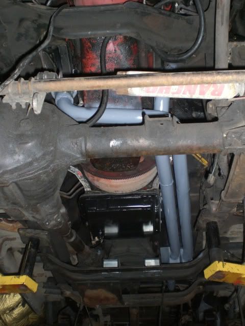

Been playing around with some new muffler designs. Think I like the size, flow, and sound of the smaller triangle ones. They can be stuffed up high under the body and I can then run the exhaust port out the side of the body.

I went ahead and installed the front half of the exhaust tonight. I went with the little triangle mufflers. They tucked in there really nice.

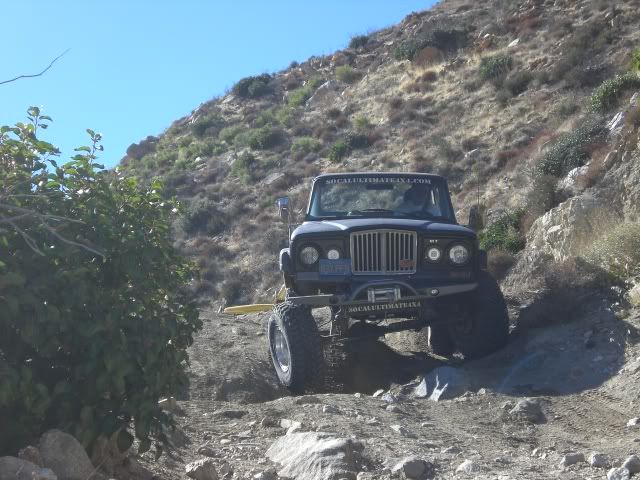

Ah man... Look at that frame flex. I know it's usually not a bad thing, but I feel so bad for that nice body to be stressed like that. May be a good time for a rol cage?
Metal Twister
Highly Motivated
LOL... I know my eyes were popping our out of my head when I saw that pic, but out of excitment. Look close, the frame is flexing but the body isnt. Im playing with different body mounts on the front clip. Im trying to give the frame some flexing room without getting into the body. Still working on it but I think Im getting close. Im using some old school technology, small coil springs. :wings: Semi Exo cage / roof rack / ladder combo in the works. hope to get to it soon to tie in the frame better for less flex.
