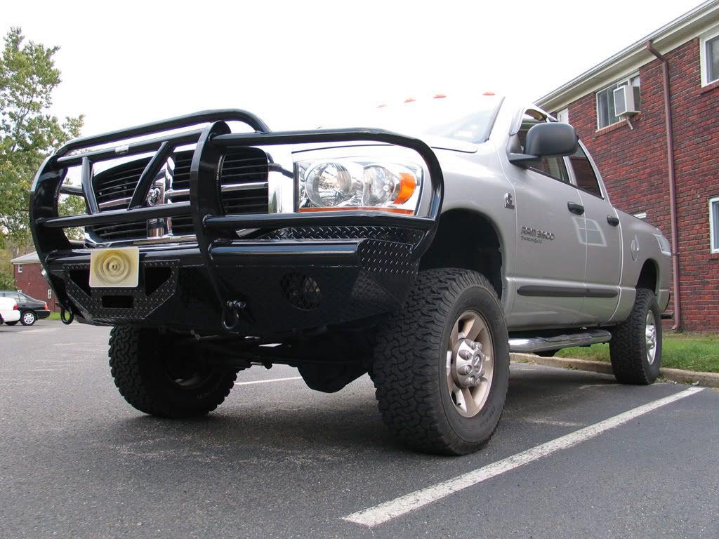

With Chevy you get a car-weak IFS, with Ford you get a "Bud Lite"-duty diesel engine. With Dodge you get a true medium duty engine (Ford uses this in their Medium duty trucks, not 250s and 350s, or even 450s), extremely strong AA&M axles (who said these were weak? the front will only bend if you you get massive air time, ie jumping the truck), a solid medium duty manual trans (Mercedes Benz Med Duty truck), and the same xfer case as the Fords (although with a worse design than Ford: slip yoke).
But since you said the Quad Cab, like mine, is too tight, I would also suggest the Mega Cab. Very comfortable and with a 2006 or early 2007 Mega Cab, you can get it with the tried and true 5.9L w/o the DPF or EGR. Also this is the same platform Dodge uses for the Power Wagon, and I have witnessed firsthand how the Power Wagons fare at offroading. Nothing GM or Ford or the Import brands can come close to for a fullsize offroad model (F150 Raptor is a Desert Racer, not a crawler). If you don't absolutely need a diesel, a used Power Wagon would be an excellent choice.
If the Dodges are completely out, then a good 2nd choice would be what most folks have already said, leaf sprung, 7.3L powered Ford with the ZF manual.
