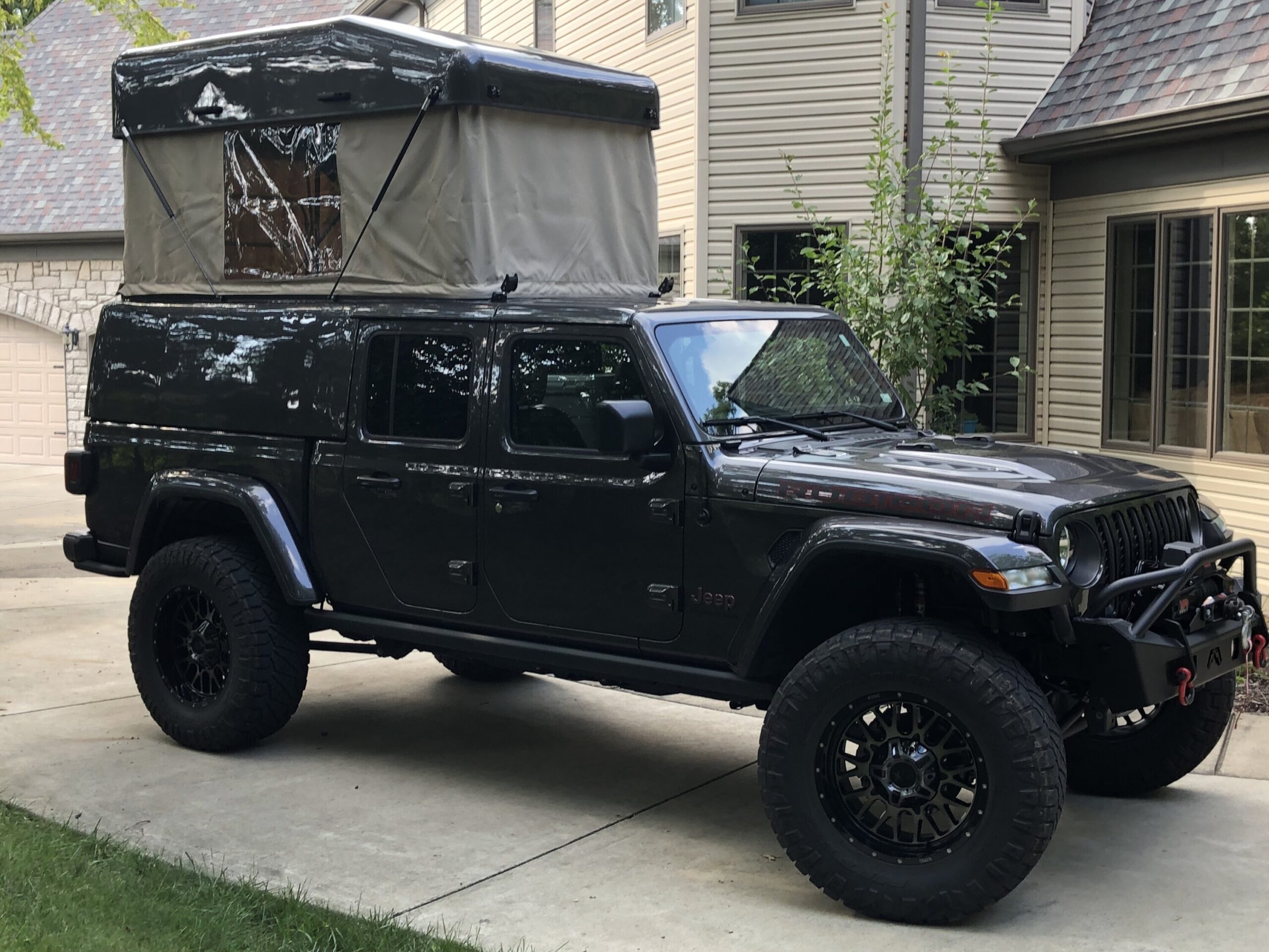

Love your camper. Do you have a thread on Gladiator forum about DIY camper?
Yes, I have threads on ExpeditionPortal.com and Jeep Gladiator Forum.
I thought that was the same setup. Such an awesome job you did.
