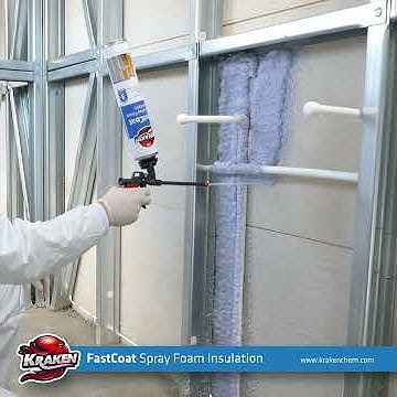

Has anyone used spray foam insulation in a can? I'm thinking about using this.
Yes but Not that brand or for a project like yours. It works well in home construction but most of those products will expand to the point that they can cause damage.
I have used a pink foam that my hvac guy used around my ductwork and it doesn’t expand as much. Can’t remember the name. I couldn’t see that vid so that may be what you’re looking into.
Have you looked at Lizard Skin? Havent used personally, but researched it at one point and it seemed really effective. I think some here on Expo have used it, and Brian on the Solid Woodworks YouTube channel had segment on it if you’re researching.
