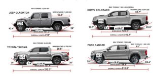

While the 'SUV' Jeep has better 'off-road' specs compared to the 'truck' jeep, the Gladiator compares very favorably to other midsize trucks (specs are from 2021 model year)
update- DISCLAIMER - I guess I need to add this as some people think a 'general comparison' somehow could cover every variation, model, and trim level (???)
BUT this is a general comparison, specs will vary by year, model, trim level, aftermarket modifications, etc.
