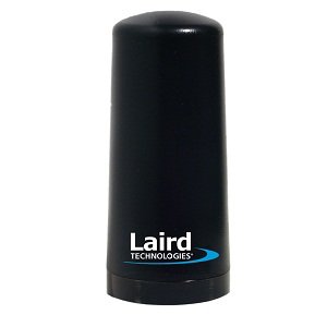

If I go with option 1, is the 7" wide roll bar enough ground plane for the Midland Ghost or is a no ground plane antenna such as this one better? The soft top fabric and plastic support ribs won't block anything, right?
You cannot go wrong with Laird antennas. Laird, PCTel and Pulse Larson are universally known for their high levels of quality and performance.
I do not know exactly who manufactures the Midland antenna, I just know they don’t build it in house.
Sent by electrons or some crap like that.

On Midland's web site it states it is a 5/8 wave antenna, and a 5/8 wave by its nature will require a ground plane. Also, a 1/2 wave antenna (one not requiring a ground plane) will still have its RF lobes flatten out at a lower angle with a ground plane under it. A 5/8 wave antenna's wave pattern, although having higher gain, has an RF pattern that is flatter and straighter. A 1/4 wave antenna, although having a "shorter reaching" pattern, its patter is more full with no "empty" spots. This is why I usually recommend ignoring gain figures on mobile applications and just use a 1/4 wave antenna.
I doubt that it is a re-branded Laird on account of it somehow being less expensive than the Laird model linked above.

Here is another option for a 1/2 wave antenna (no ground plane): https://www.amazon.com/gp/product/B00IDTJ2KE/ref=ppx_yo_dt_b_asin_title_o01_s00?ie=UTF8&psc=1

Is this accurate regarding ground planes in mobile applications not needing to be perfectly shaped? Radial length of ~6" would be a ground plane of 12"x12" or 144 square in. But if it doesn't need to be perfectly shaped, my roll bar being 7"x24" meets the minimum requirement. This Larsen Mirage puck antenna actually specifies a 20" diameter ground plane, which would be 10"x10" or 100 square inches.
That Larsen puck is the one I was referencing earlier. I was a bit mistaken as it “only” requires a 20 inch circle, not a 24 as I earlier stated.
