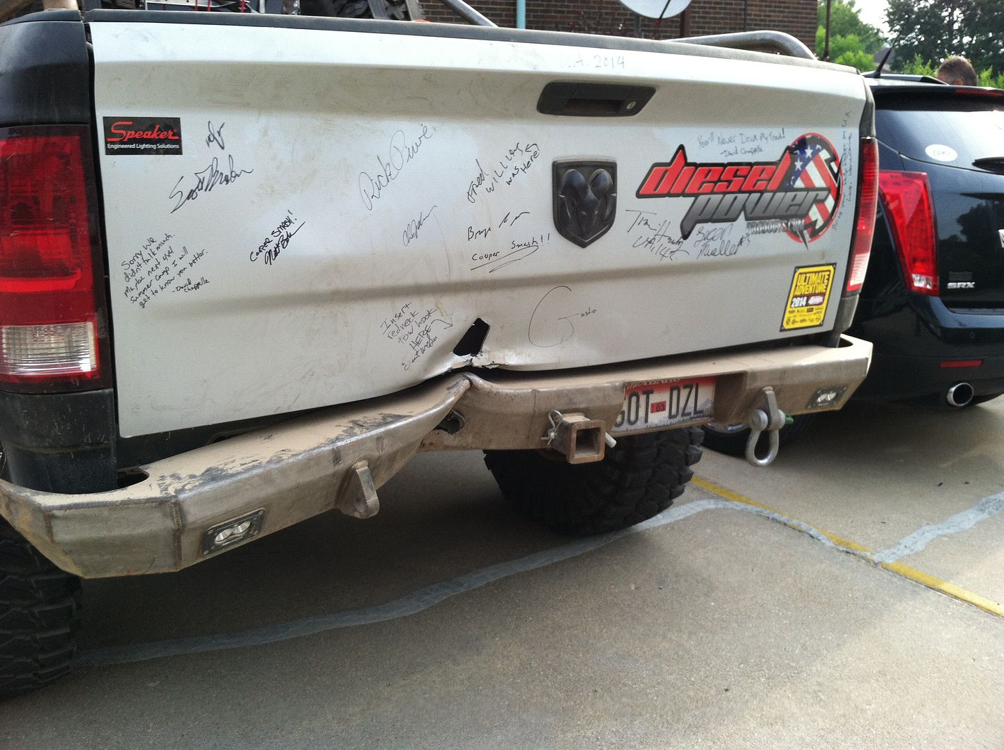

WoW! What was the weight of the metal that hit the truck.
