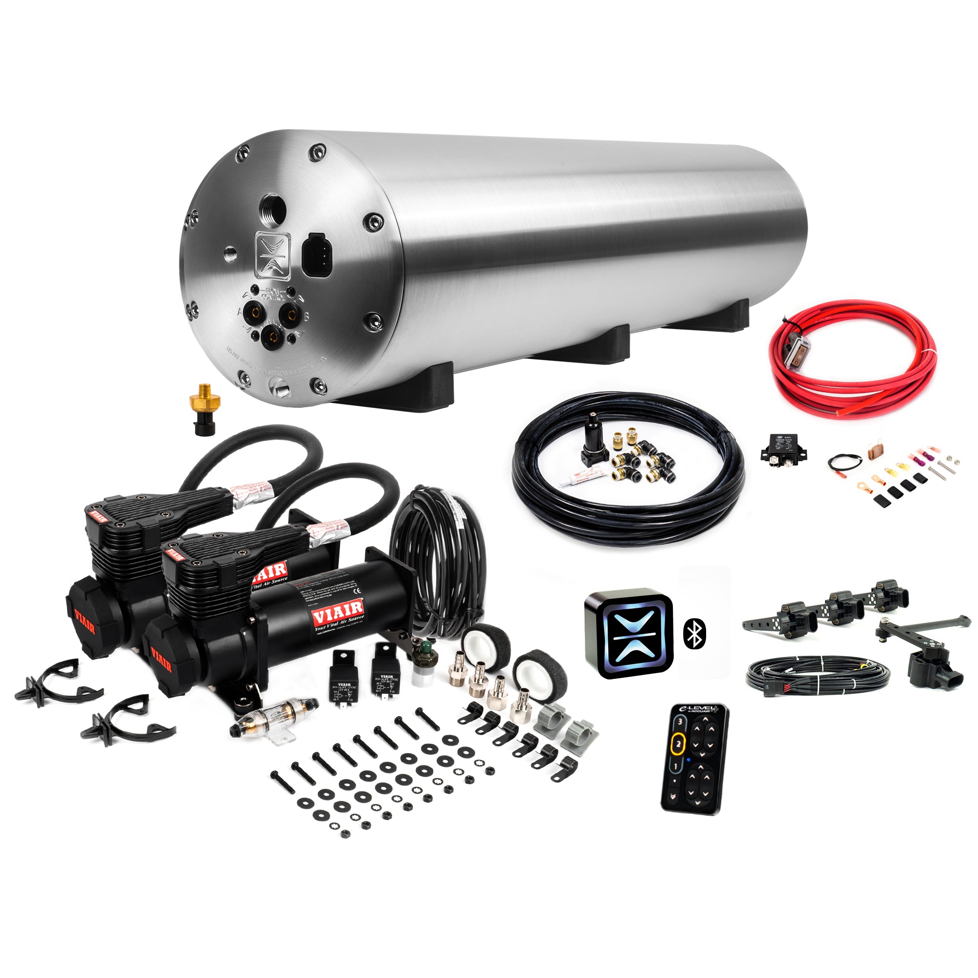

Can't really help with the actual bag/suspension part but for air management/auto level, you might look into this system. It is used widely in the hot rod/classic car world.
