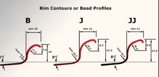

As far as 20" wheel vs 22.5" wheel go for off- road trucks.
These are the normal 20" rim contour - they make sure the tyre stays on the bead at lower pressures.

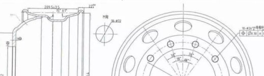

This is the 22.5" wheel rim conour, much lower, makes it a lot easier to get tyres on and off, but you need to keep the tyres at a higher pressure or they will de-bead and ruin your day.
