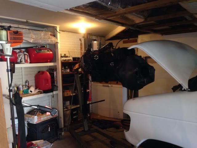

Do you think after I do a dump run, my cherry picker will fit and have enough room?
Plenty of space. Support the engine and roll the van back.
Cool..
After I put 20 psi back in all tires, the van just barely touch's the door when its up. I will have to strap the suspension down before I remove the engine to be able to even open the door after the engine is out..

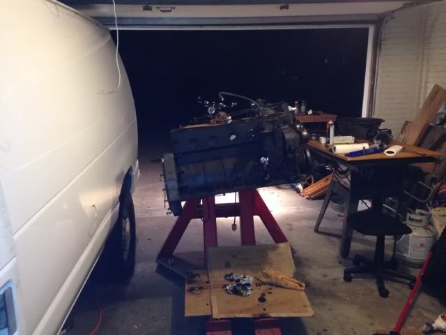

Engines removed.. Accessing the damage.
My Machinist mentioned the cylinders didn't look so bad, but still no word yet.
