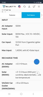

You asked about the 100w dc input that rruff mentioned. He was talking about the cigarette lighter plugin that the Bluetti ac200max has, and most all cars have. You also asked about,
power stations don't charge very quickly when plugged into a vehicle's inverter. Does anyone know of a way to overcome this?
This isn't quite right, it is that power stations recharge slowly when plugged into a car's standard available cigarette lighter! Why? Because in order to keep those from catching fire, they were standardized at 100w max long ago! A few are 12v 10a, so 120w max, but in general that round plug in your car can deliver 100w. Because of this, most all power stations have an input to be easily plugged into the one pre-existing 12 source in every car, the 100w cigarette lighter. But 100w isn't much power, your Bluetti ac2000max would take 20 hours if driving, x 100w per hour, to recharge 2000wh.
Now, none of that has anything to do with a car inverter. Existing car inverters are a new and rare thing, in some pickup truck beds. So they can run some smaller power tools. And YES, you can just plug your power station directly into that inverter outlet in the F150, no wiring or messing around, easy. My Tacoma can deliver 400w when sitting still. I looked up some pages on the f150 invertor, it depends on your trim model and year, but they had 400w up to 2000w. That is your easiest solution, as you guessed.
Here are the specs for the input output for the ac200max. You can see the 100w car dc input listed at bottom, the ac standard charger 500w input near top, the 900w solar input, etc.
