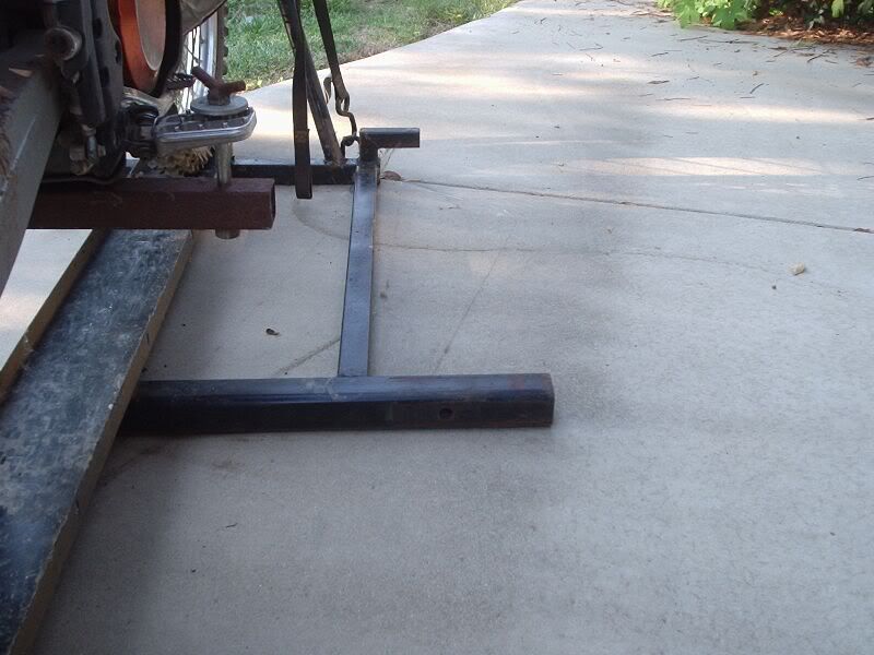

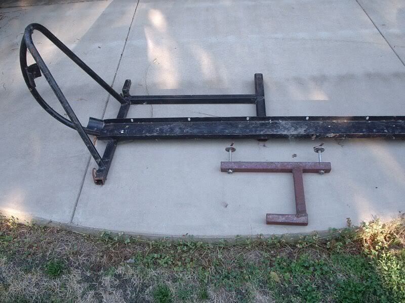

I built my own bike hauler that has bolts that go through the pegs, very secure. I will take some pics and post them here.
Sean
O.K. here are the pics. I used this on a full size Bronco for about a year. I got rid of the Bronco and the rack has been sitting in my shed for about 5 years now.
First I put the bike on the rack with tie down straps and compress the forks about 3", this holds the bike up and pulls it forward. Next slide the peg bracket in the reciever tube to line up the holes with the pegs.There is about 2-3" clearance between the skid plate and the peg bracket.Then compress the rear suspension by pushing down on the seat and insert the bolts through the pegs. This will hold the bike in the channel. I have not found it necessary to pin the peg bracket. Even if you tried to pull the rear of the bike sideways it would not go anywhere as the peg bracket assy. will bind with the outer tube.
I made a "mini" reciever and bolted it to the rear bumper on the driver side and there is a small tube on the front left of the rack that goes into it to prevent side to side rocking.
Wow Sean.
First of all, thanks for taking the time to set up and photograph and document everything for us. Its very appreciated and really helpful.
2nd of all, what a great design. I like everything about it. The front tire holder, the anti flex piece, and especially the foot peg bolt down system. I'll be able to incorporate these ideas into a tray for solid and secure transport. Thanks a ton.

Hey Uhauler thanks for the pictures I was thinking of doing something like that but was not really sure if would be enough to keep the bike sturdy when four wheeling. I imagine with the front wheel bars helping support it, it would be enough to keep it secure. I will incorporate you idea into my rack, I really do not like the idea of straps holding my bike from falling off the back of my van.
Thanks again,
Derek
