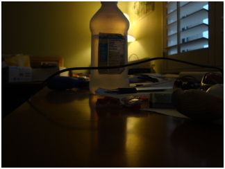

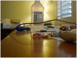

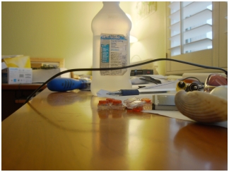

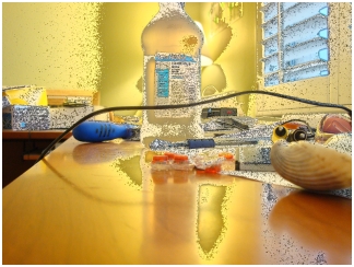

Here is my first Pskhaat algorithmic attempt which basically interprets the deviation of the color channels and chooses the highest deviation across a 3x3 matrix. Now I need to go read how the pros do it:
-2EV:
0EV:
+2EV:
1st attempt:

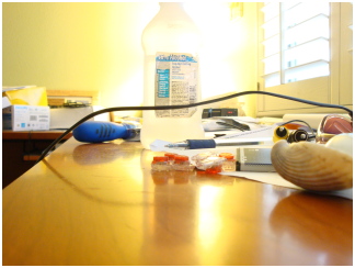

2nd linear attempt
3rd attempt with RMS:

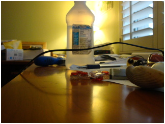

0EV:
2nd attempt (like nothing ever happened)
Wow ... marked improvement, both in comparison to the first go and between this one and it's 0EV exposure. Nice work ... and kudos for the pursuit.
