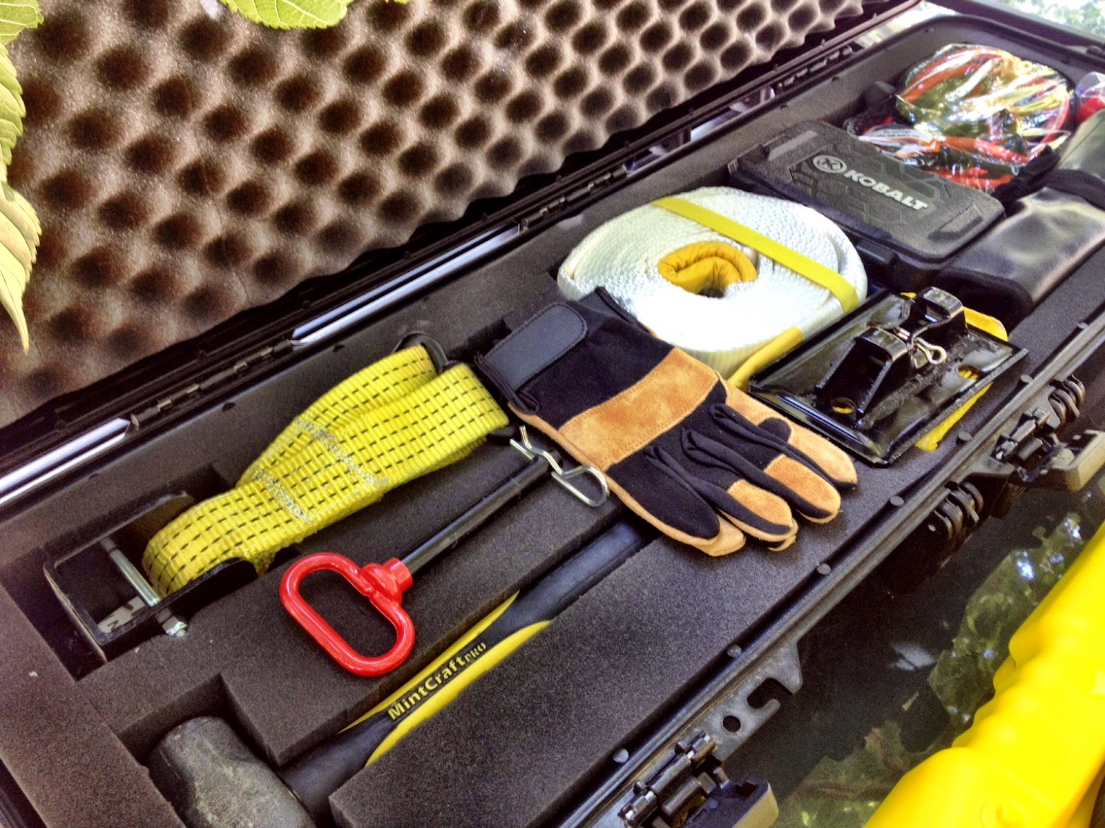

All recovery gear except the compressor is up top with smaller items in a weather poof tactical case. The Viair 300P compressor is stowed in the cargo area.

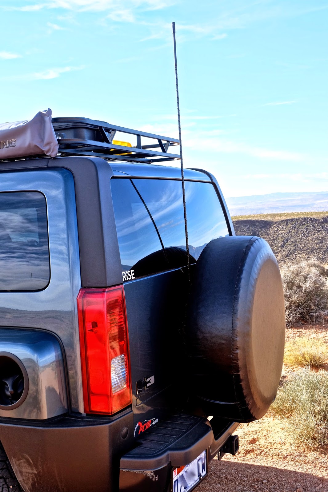

Eighteen feet of coaxial cable with Pl-259 Connectors connect the head to the 4' Firestick tunable antenna mounted behind the spare on the rear of the H3.

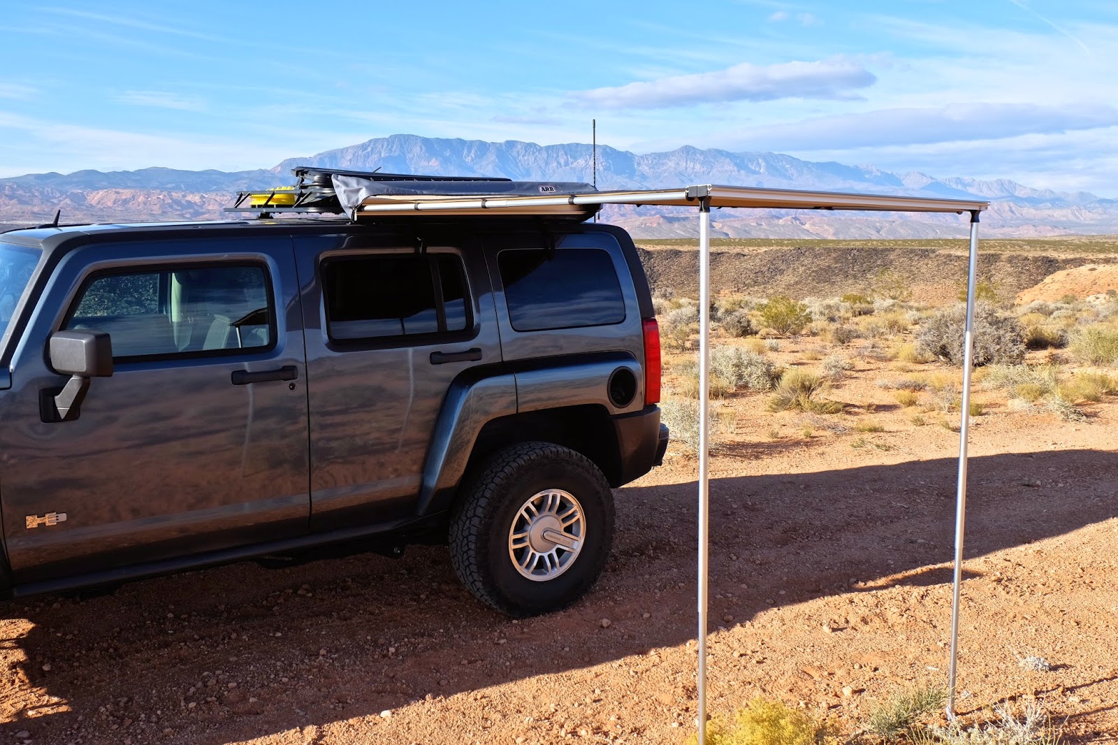

ARB 4' Awning - I had an Australian 60" Eezi Awn awning on the Montero that converted me to the idea, but not to the convenience since the Eezi Awn's cam system in the legs was unstable at best in calm conditions. This ARB awning solves that and other issues.
Its engineering makes it easy to deploy by one person. The construction is top notch with reinforced corners on the awning and clever plastic disk stays on the struts and legs that keep all the hardware in place until it's deployed. Stowing is a cinch in its PVC reinforced nylon bag with two d-ring velcro straps and heavy duty weather-proof zippers.
When researching the ARB 3110, or any ARB awning for that matter, I couldn't find detailed images of its build and deployment, so I'm posting these for those searching for the same:

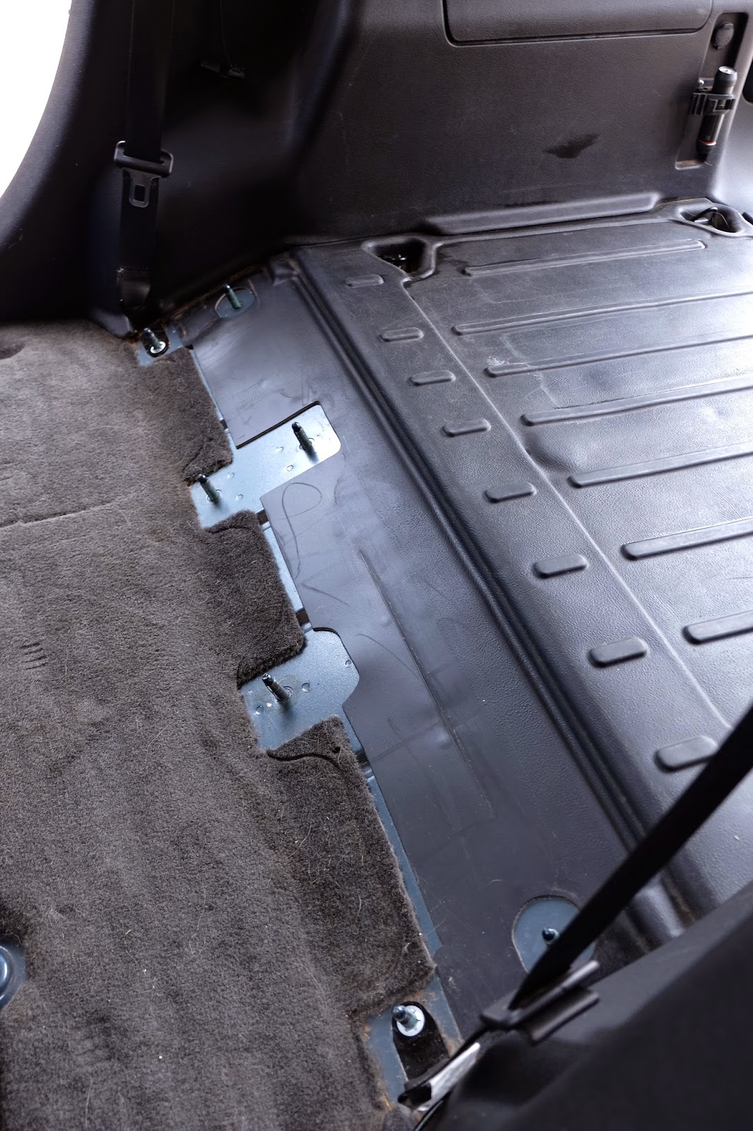

Rear-seat removal is straight forward, remove the bottoms from their easily accessible mounts, and then the backs. The 60/40 seat back is mounted on a sub-frame that keeps the backs aligned and rigid. With everything out, this is what's left.
I removed the seat-backs from the sub-frame and reinstalled it. There are two spring loaded doors integrated into the transition that kept debris from falling in between the seats and the cargo area. I though these might be nice to maintain an access to the underside of the platform.

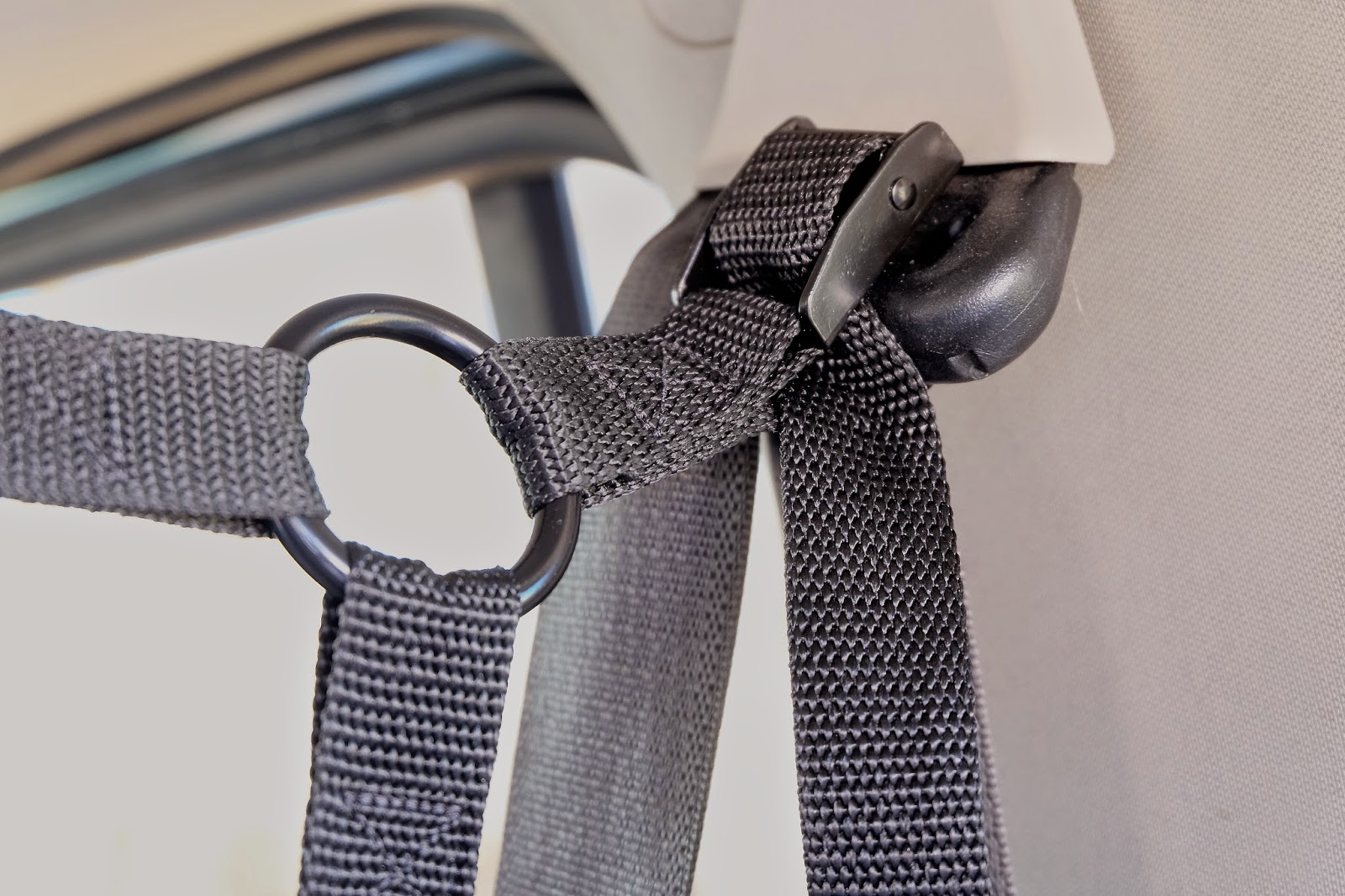

I attached the net to the seatbelt guides that are bolted on the C-pillars. The base of the net is attached to hardware loops that are welded on the sub-structure that I remounted.
