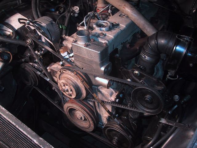

Over the past few years I've slowly become a diesel-nut. My first was a 1985 FJ60 that I swapped an Onan L634T (old old UPS truck engine) into. Was a nice little motor, but I wasn't totally satisfied. It actually pulled better then my friend Luke's 12HT-powered HJ61.

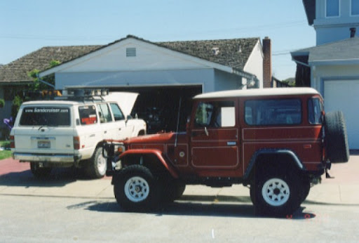

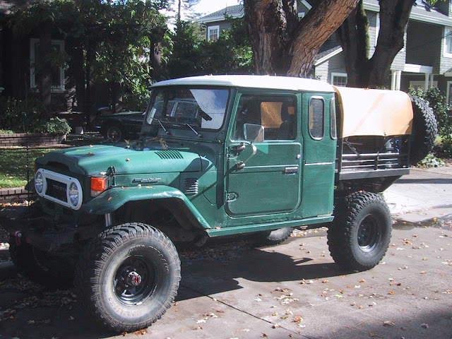

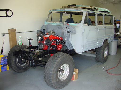

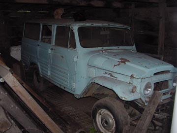

FJ45LV before reconstruction

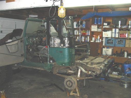

FJ45LV during reconstruction
The old V8J60 (TBI305, H55F, Mark's Gears, Alcan Springs.)

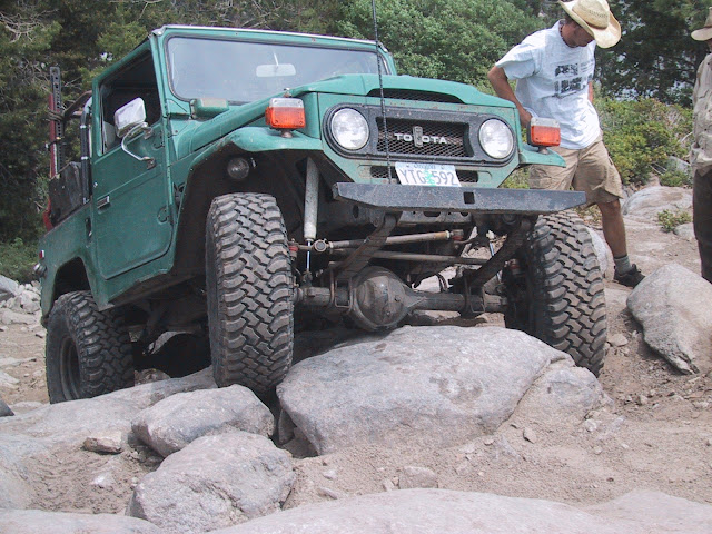

The FJ46 Under construction
The FJ46 mostly finished

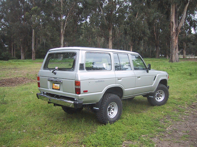

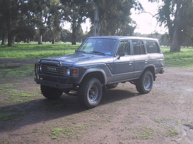

1985 FJ60 with BTB Springs, H55F, and Onan Turbo Diesel
Onan L634T (aka Cummins 6A3.4T). This is a 3.4, IDI turbo diesel found in really old UPS trucks. Nice little motor, harder to find parts for these days.
The FJ46 Before Transformation (FJ40 Form)

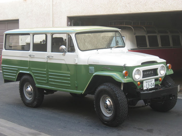

the same FJ45LV after I sold it. Hard to believe this truck was on Rubicon, eh?
