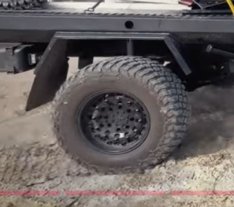

I'm modifying some rear fenders I bought. See the fender picture below? Does anyone have similar fenders over 37's and can give me the measurement of the top surface?
