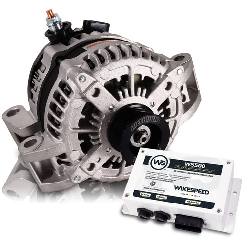

Dedicated second alternators are a bit different in that they can often output more than 3kw, which allows for short idle periods to charge a battery. In which case they are closer to a generator than a typical DCDC. Though high power DCDC chargers are somewhat available.

I haven't decided for sure what route I am going, but I did spot this 48V option which can be made to fit the second alternator spot on the Ford 7.3l gas engine. 4-5kw of output is pretty darn good, and with a 9-12kwhr battery pack should meet 98% of our usage when combined with ~1-1.4kw of solar.

I don't have a ton of 12 volt chassis loads, so the stock to 250A single alternator will work fine. With a dedicated second alternator charging the house battery I think that's the way to go. I think I'll install a 48v-12v dcdc to keep the chassis battery topped up.

I am discussing a second alternator with a 5 kilowatt output. And using a $80 DC/DC charger to keep my starter battery topped up when parked.
