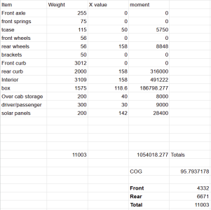

Did some weight distribution math, looks like my planned 14ft box will just work weight wise. This includes the weight of a 4x4 conversion, and 34" wheels and tires, plus water, food, passengers etc. Load range F tire is good for 7940lb, so there is a bit of margin. I would like a touch more weight on the front axle, but there isn't much to be done with a 158"WB and a longer box.
That seems off, even with a 158" wheelbase, unless there is a lot of heavy stuff behind the rear axle. The chassis is very biased to the front, and at the camper floor you have ~100" in front of the rear axle, and 69" behind.
I have a 75-100gal fresh tank located just above the rear axle. The longer rear overhang and the "garage" being back there biases the weight rearward as well. Add an AC unit and spare tire to the rear wall to round it out. My math was based on the reported curb axle weights, COG of the box and contents, and the estimated 4x4 bits. I do basic COG calcs for aircraft mods on occasion, so unless my inputs are wrong, I am fairly certain the math itself is right.

FV confirmed the subframe and box weight is 1575lbs. Which is within 50lbs of the estimate I was using for my math. Some really rough numbers for COG, so I could figure out approximate axle loading. The interior is based on a CAD model I through together for planning that has the major components and cabinets approximated. COG is reported as distance from the front axle.

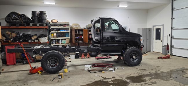

To clarify the chassis is getting its running gear installed. We are tentatively in the 1st quarter 2026 queue for getting a box installed.

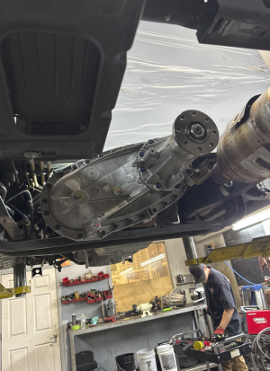

Transfer case going in. I am enjoying a fresh/new chassis for as long as I can. Knowing me it won't ever be this clean and rock chip free again!
Are you looking at rear axle weight, with 12 ply tires rated at 3970lbs each, and making sure your at 82% capacity or less?
Curious, how much ground clearance does the transfer case have?
Won't know until the vehicle is fully loaded, but the cross member is about 4.5" below the bottom of the frame rail, give or take, and the Tcase is about level with that. So some impact to breakover angle. The Tcase is fairly close to the front axle, which mitigates the breakover impact some, at least compared to a unit mounted closer to the midpoint. If you look a bit further forward you can see the trans and engine oil pans, which are approximately the same height.
