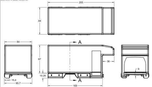

Foundation Vehicles sent me some details on the E-series box offering. I asked for some weight and interior dimensions. I also inquired about alternative door options. The box has an integral step-well, so deciding on door location needs to be done before the panels are fabbed.

I'm sure I can probably save some money by diy a bunch of it. Given a14 ft box, I would need a bit more than just some poly isolators based on my math. The box itself isn't designed to mount directly, so we'll need some type of frame for support. The GT subframe is also quite nice being galvanized and then painted.
I have a mix of limited time and space. It would probably take me about 3 months to measure design and fab a subframe. And of course that also includes a bunch of the headaches of building and testing a prototype. I also don't really want to deal with assembling that large of a box myself.
GT is also supplying the box. Price is somewhat competitive compared to other offerings.
As far as the overhang goes I'm aware that it will produce limitations. But that's the trade-off I need to make in order to have something that I can full-time in with a child, and a reasonable level of comfort. I don't do hardcore wheeling, and really avoid true 4x4 routes most of the time. But decent ground clearance and the ability to drive out of the occasional screw up are important. If I really need more departure anangle, I'll uprate to 37 or 38in tires. Currently planning on 34/35" singles.
