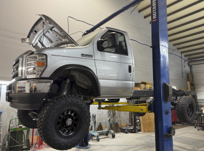

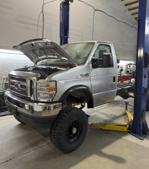

Nearly there, just waiting on the rear driveshaft!
Should settle quite a bit with the full payload and some miles on the springs. Hopefully not too crazy a step-up.
