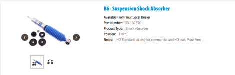

Another one bites the dust. Less than one year old, the Skyjacker shock absorber blew up. They have a lifetime warranty but they need to be inspected by an agent and also they have to match the application, yadah, yadah,... I'm not going to waste my time. I pace an order to Bilstein B6 for E450 RV. Let's see how they perform. On van#1, 2WD I had Bilstein and liked them a lot. Van #2 (rigrunner 4x4) had Fox and was not impressed, especially for the price.
Amazon product ASIN B009FU7IOM
