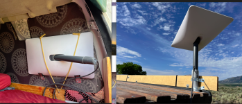

On the "gadget" side. Two great additions. Starlink and an Airfyer. Starlink allowed us to be in touch for work. Placed against the inside wall and with the connection on the roof rack, I'm able to set it up in 15 seconds. The router is mounted on the fridge cabinet.
