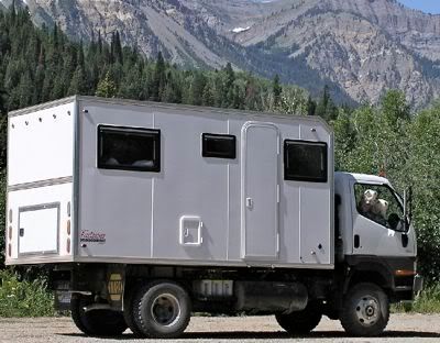

When you build the second version, you may wish to consider composite panels. There is no nasty fiberglass to deal with, no chemicals to mix, no sanding, brushing, etc.,
A customer of mine has panels to make a 12 foot long by 7 foot high by 7 foot wide RV box and the panels all together weigh well under 500 pounds. The walls are about two inches thick and they have an R value of of about R-30 with a special heat reflective coating sprayed on the outside after final assembly. The panels are bonded together with a something along the lines of Sika 252, depending on the composition of your panel. Thin aluminum or composite extrusions can be used on the exterior to further seal the joints and offer some protection against branches and such. It should look something like this when completed:

so if that box empty weighs about #500, the one for your JKU should not be anything near that, which is what you have now.
Would it be possible to get the panels to curve so that they follow the contour of the Jeep? As far as joining the panels, is there a way to do this seamlessly (without aluminum extrusion)?

You got my interest! 2" walls and R30? That's unheart of. We are getting R20 with 3" walls. I would like to find out more. 500LB only for a box that size doesn't sound right... In any case, please tell us more about it.
They are quite rigid, so I doubt simple or compound curves would be possible. The manufacturer may be able to build you a curved panel or you may be able to get a thinner panel and bend it to suit your needs, but it would only be a simple (2D) curve, not a compound curve. Composite structural panels just dont do that, that I am aware of, but I am not an expert in that field.
