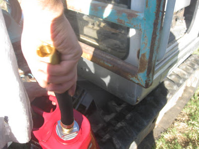

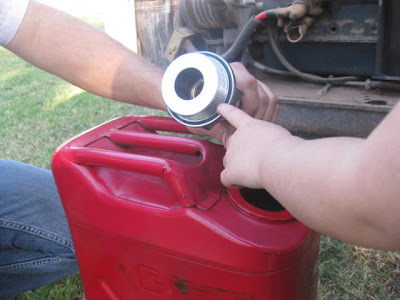

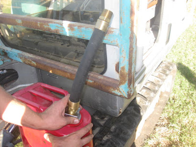

I have been working on a new product for this very application so far I have one that is for Diesel sized tank fillers.
It has an o-ring, This spout will not leak!
Its makes fill ups allot easier because of the forgiving nature of the Curb pump hose I use and has great adaptability with bras pipe crimped to each end.
I haven't got around to having my machine shop machine one for smaller hoses let me know if you are interested I will shoot you a price.
