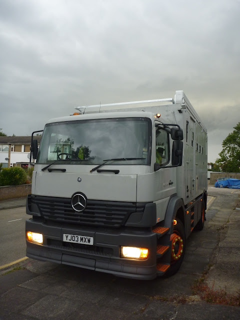

The curb appeal in the picture you posted above is terrific. Please let us have more info. and views.

Thank!
I'll try to take some more photos as I get time, although I've got a few I took earlier in the year for an application for emissions control exemption.
Is there anything in particular you'd like to know?

In some places yes. The construction of most of the box is fairly standard, using a 50mm deep steel frame, clad on the outside with plywood walls and an aluminium roof. The difference is the internal cladding, at the back of the box the walls are 3mm steel and 3mm aluminium and the ceiling 3mm steel. But at the front, there is a cladding of 3 or 4mm armour steel. This stuff is a comple ******** to drill and so I presume it is more bullet resistant than mild. The same stuff is used throughout the cab, there is a full solid internal cage of the it, with the only apertures being the windows and the walkthrough to the box. The armour steel is also used to line the bonnet, and the area around the front of the cab. The cab side windows and the windscreen are also bullet resistant, being around 15mm thick (difficult to tell).
When I get time I will remove some of the easy pieces in the front of the cab, but the internal cab cage is welded in situ and so that is staying. I quite like the added security of the windows at the front, but it is a pain not being able to open the cab windows. The air con is good, and there are loads of windows and roof hatches that open in the back, but I forsee problems in really hot countries where the air con doesn't keep up and I cant get a breeze across my face.
I have replaced the armoured side and rear doors in the box. Both were ridiculously heavy and had dropped a few mm on their hinges, making them a pain to operate. They both had 24v solenoid operated sliding bolts, and electro magnets, in addition to the manual 3 point locks. I have also removed the bulkhead between the safe section of the rear box, all back from the side door, and the front operators section. I reckon I removed about three quarters of a tonne of steel before putting any weight back.

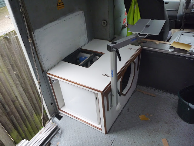

I've all but finished the nearside bench seat. There's a small bit of cladding to complete over the electrical locker, the teak needs a final coat of varnish, and it obviously needs upholstering. I'll probably leave the upholstering until most of the dirty work is finished.
I'm impressed with the Lagun table so far. Thanks to Earthcruiser for the idea!
