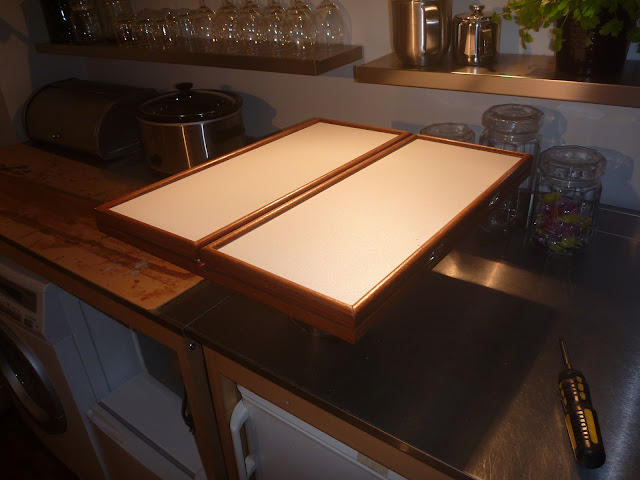

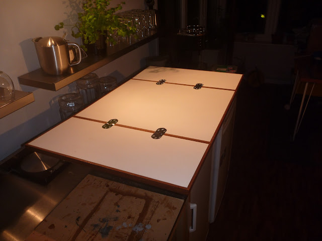

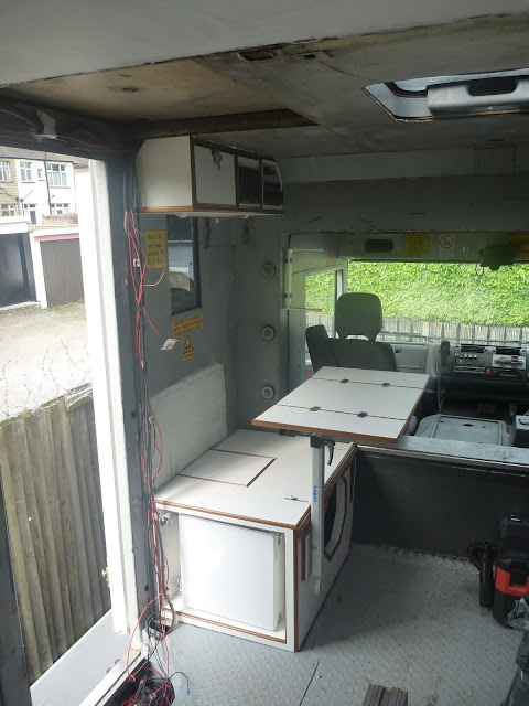

I had a little time to build a table top for the Lagun table. Hvaing a few problems with the hinges but nothing unsurmountable.
And here's the blog post:
http://jimthetruck.blogspot.co.uk/2012/10/table-top-1.html#more

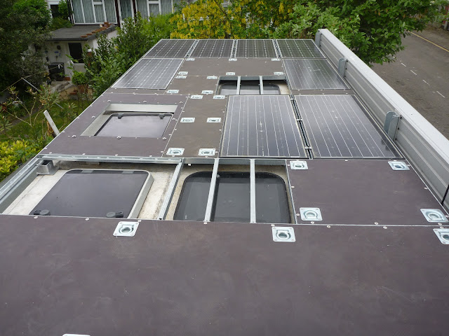

I've had a bit of time to start installing the solar panels.
http://www.jimthetruck.blogspot.co.uk/2012/11/solar-install.html
I've got 5 of the 8 100w panels installed, although only 4 are wired into the regulator as I am doing 2 parallel strings.
The is more info on the blog post. I'll let you know what sort of output I'm getting when we finally get some sun. The sun is pretty low in the sky at this time of year but the cold temperatures should help get a reasonable charge.

Looks good !
I done a similar clamping job using the same but flathead security screws, Then filled the recess with epoxy, smoothed then painted over, one cant see at all what the fastener is, But its still reasonably enough easy to pick out the epoxy to fit the torx driver if needed
Thats a good idea, if you do it carefully they'll look like coach bolts and someone fidelling with them will get confused when there's no nut on the back.

Do you think you have enough solar? Haha.

Thanks John! I may buy an extra base so that I can put the table outside, but the door for the generator is hinged at the top so if I put some stays in, I'll have a 60cmx60xm table out there regardless. At the moment I'm having the truck tested as a heavy commercial vehicle, and any protrusion on the side guards is a fail. When the inside is completed I can test it as a motorhome and there are less restrictions on the sideguards and rear underrun. I failed the annual test a few years ago for having hex head bolts instead of button head holding the side guards on! I can't envisage any scenario where the type of bolts could limit injury if you could hit a pedestrian with an 18t truck.
Where the table is now, I can swing it towards the back of the truck and if I raise the post a few cm it'll but up against the kitchen worktop to give me an 85cm extension.
The UK gets a little less sun than Queensland! The batteries are on their last legs and I'm hoping the solar will allow me to get a little extra life out of them. But you're right it is an unnecessary amount of solar.
Hi Nick,
I was only kidding.....the solar array looks great and with the price of panels now why not cover the roof.
I work on 5.5 Peak Sun Hours where I live but parts of our country are nearly 7 which is like the Sahara I guess!!!!!

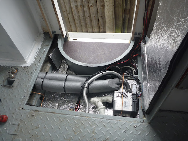

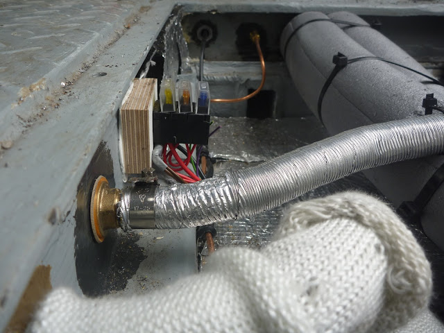

I have been doing a lot of furniture details up until a couple of weeks ago, but I've now completed the Webasto water heater install and have finished installing the gas locker.
Here's some blog posts about some of the work I've been doing, I'll post about the gas locker later today:

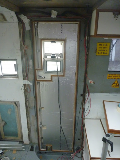

Side door cladding and insulation:
http://jimthetruck.blogspot.co.uk/2013/06/door-cladding.html

Webasto water heater installation:
http://jimthetruck.blogspot.co.uk/2013/07/webasto-water-heater-installation.html
