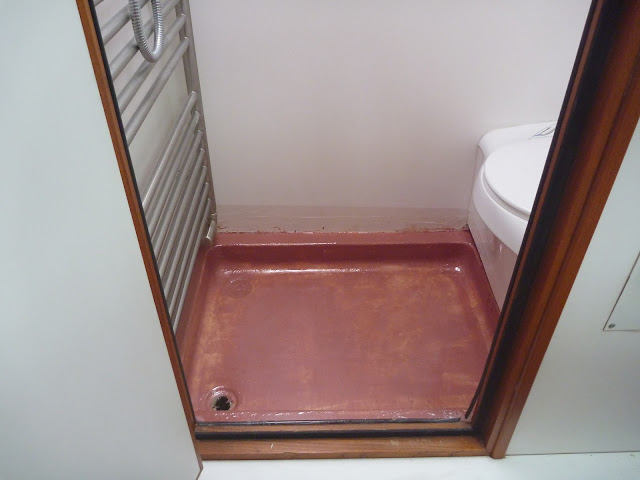

I had a little time recently to repair the shower tray which was cracked and rapidly disintegrating.
http://jimthetruck.blogspot.co.uk/2015/08/why-you-should-always-listen-to-your.html
It would have been a huge pain to remove the old tray, and so I effectively fibreglass a new one inside it.
Nice job Nick. I have to do the same a mine is also cracking. How did you deal with the bobbles on the old tray? use resin to level it off?
Edit: should have read the blog first! Good idea sanding flat. My other though was to make a stainless steel tray and drop it on top of the old one. However the edges of the tray and sealing it in becomes problematic.
I did consider this, although in my case I would have had to remove the towel rail to get such a fabricated tray in place. Another option that I considered was to have the tray sprayed with a hot applied bed liner product such as Line-X or Speedliner. Time will tell whether I made the right decision, but I am happy with the finish.
