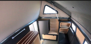

I don't have Michael's fabrication skills or attention to detail, so I had the interior of mine built by Goose Gear in California. I am extremely happy with how it turned out, and I think it's going to be fascinating to compare Michael's interior to mine.
I am loving the differences in our campers so we can learn as much as possible.
-Dan
PS Michael took that great photo in the video thumbnail!

Thanks Dan! I love the wood finish, all the cubbies with bungee cords, and the induction stove. Looking great!!
Great photo Michael!! It shows off the layout and size.
Mine will have a bed platform upstairs, I think Michael is currently planning to have his downstairs area convert into a bed.
Again, a great way to learn the pros and cons of each approach with a direct comparison.
