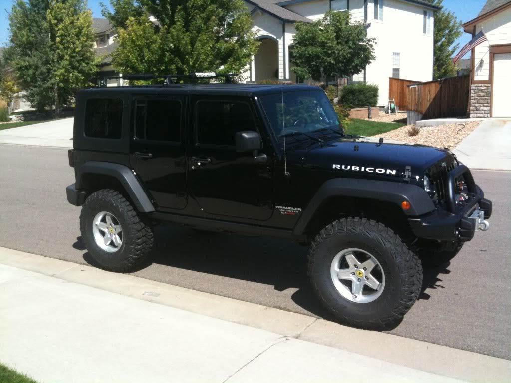

Pictured below is my Jeep as it sits with the Polyperformance lift and MTR tires.

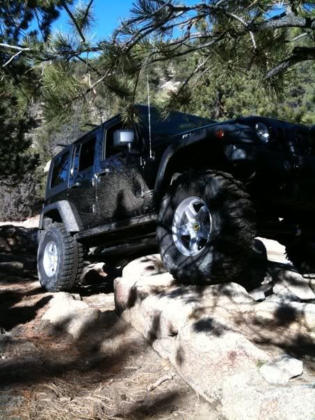

Here is Jerry's Jeep with the Teraflex lift the 255/85/16 BFG.

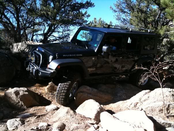

First. I have an AEV 4.5" and 35s (37s soon) and LOVE it. Wonderful suspension.
Secondly, I have a 4 door auto (rubi) and run 5:13s. The stock OD on the auto is WAY WAY too deep.
An auto JK with 35s and 5:13 is within 50rpm (yes 50) of a stock 6 speed rubi(4:10 on 32s.) at highway speeds. The auto really needs a bit deeper gearing.
I towed this car from Flagstaff, Az to Denver, Co with 35s/5:13. Set the cruise at 65mph and it towed the whole way in OD at 19mpg. Only had to drop out of OD to pull Raton pass.
(Not the AEV suspension in the picture, this was a RockKrawler 3.5" I had before the AEV 4.5")
