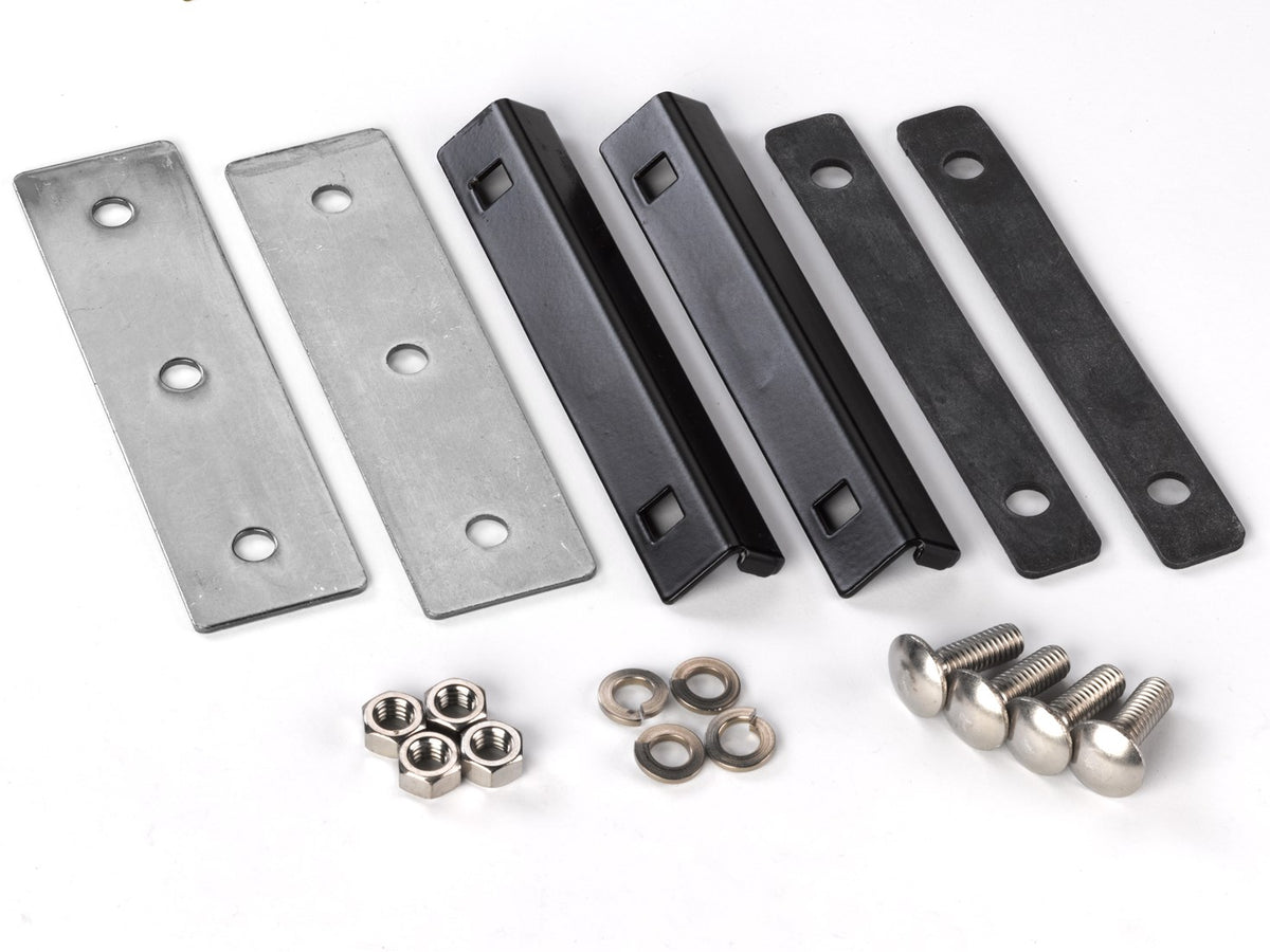

Has anyone added / used add-on gutters on the rear of their hard-top? I want to use a full-lenght rack, and would like to support the back half, but the JKU gutters are stupidly only over the doors. I had a Gobi, but like the flexibility of the gutters.
Yakima makes add-on gutters. These could be attached to the top by drilling by the rear window (from the side). The clamp load should be pretty significant.
Something like this:

I saw the Smittybuilt rack (Defender). As you said, the rear mounts to the rear glass hinge bolts. I'll have to take a look at my hinges. I don't know if there is access to the "bolt" that holds the hinges on the inside, or if they're molded over. May be a good way to go as long as there is sufficient clamp load. $90 for the mount kit (2 rear glass mounts, and 2 gutter mounts).
