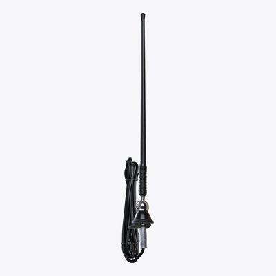

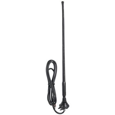

I swapped out my antenna for a powered rubber stubby antenna. The install was a total PIA. I was unable to use the original antenna cable, and feeding the new one through the fender in through the dash behind/beside the glove box was one of the most unpleasant things I've ever done. I am NOT a small, delicate, mechanically inclined person with precision fingers and dexterity! I ran a positive lead to the battery, and my reception is the same if not better than previously. Oddly, AM reception is almost non-existent now, but FM is amazing. It was a cheap $10 antenna at AutoZone

Okay guys, here is a basic photo of the install. I can't recall which of these two products I purchased. I remember holding both of them in my hands and not understanding the differences between the two of them. I probably just bought the $14 one, but I am not certain.
- $10 powered rubber mast antenna: http://www.autozone.com/autozone/ac...4-in-cable/_/N-25b4?itemIdentifier=15259_0_0_
4
- $14 powered rubber mast antenna: http://www.autozone.com/autozone/ac...enna-unit/_/N-25b4?itemIdentifier=296739_0_0_
