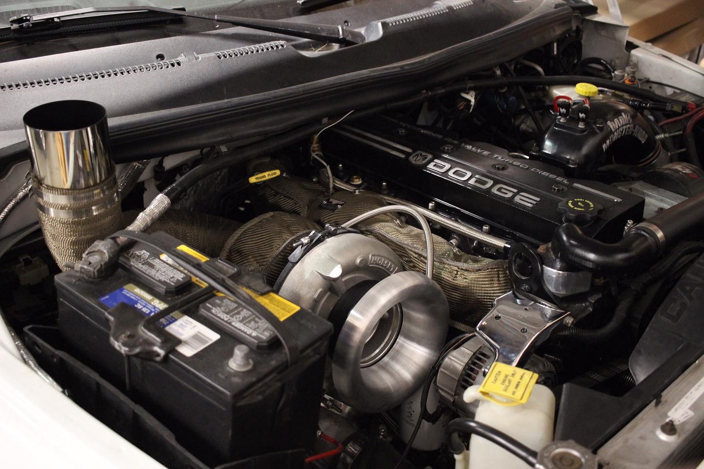

For the engine, I toned it down from an extreme 850hp to a modest 450-500hp.
A Fenley Turbo HX35, F1 Mach 2 injectors, etc:

Speaking of Duncan, his turbo transformed the truck. I can use cruise control now that the spool up is so quick. I think this is his 60mm HX35R with race cover.
