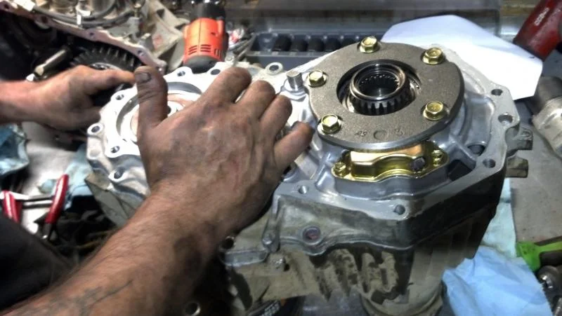

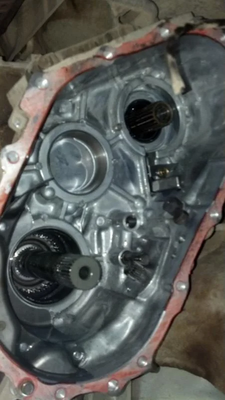

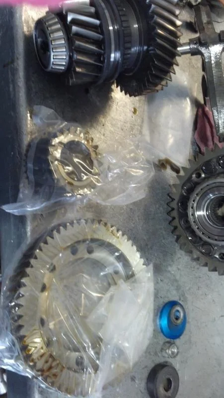

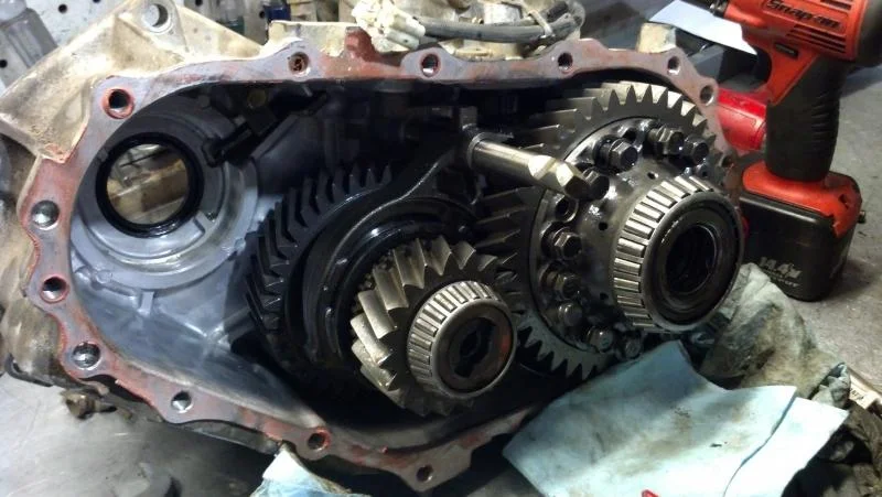

Transfer case gears
Also added before Cruise Moab 2012:
These gears replace your stock 2.488:1 low range ratio with a 3.116:1 ratio! The end result is a 25% gear reduction for your FJ80, FZJ80, or 100-series Toyota Land Cruiser, which combined with your automatic transmission's torque converter, results in almost a 75% total reduction for awesome Rock Crawling No replacement bearings, seals, or gaskets required. Installation is simple to accomplish using standard hand tools, shop press, bearing splitter, and grinder. Requires silicone, thread sealant, and replacement gear oil. Your automatic transmission fluid does not need to be changed
Made in Japan, OE Quality. Fits all 80, 100, 105 series Landcruisers.
  • [FONT=&quot]1 - Differential Low Speed Gear[/FONT]
  • [FONT=&quot]1 - Idler Low Speed Gear[/FONT]
We just installed these in our 100 series before Moab last week. Results are excellent. No change is made to high range, but the heavy Landcruisers really benefit from the lower-low range.
Retail $799 for the set. Attached Images
attachment.php
attachment.php
attachment.php

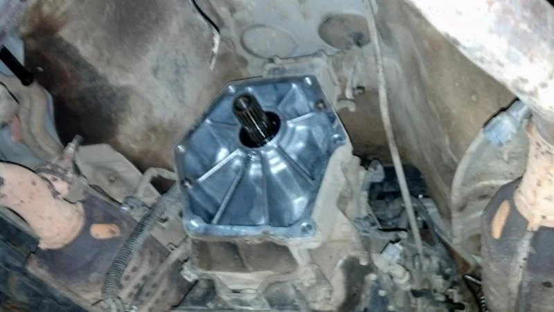

Mine's a 99 so with the 4 speed Auto, it pulls very hard on the 2-1 downshift if you stomp the throttle at say 10mph. This would cause some torque steer and have a tendency to burn off 1 front tire in loose or snowy/icy conditions. I noticed it pulled much straighter with CDL engaged. I installed the back half of an FZJ80 Transfer case to get the viscous coupler. All a direct fit, just had to shorten the driveshaft 3". Results are much nicer overall tighter feel, more controlled acceleration, much better traction in unlocked high range in snow. Attached Images
attachment.php
attachment.php
attachment.php
