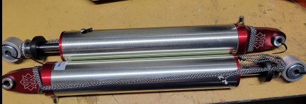

Last year I replaced my shocks. The shocks were still fine, but I was looking for more damping to the sway at highway speeds 75-80MPH on bumpy stretches or just poor highways at lower speed limits.
I contacted KK and they have some new Profenda shocks (Never heard of them) custom designed for our Karavans that use the longer shocks. Mine is a 2016.
I asked to KK about shocks and They said
"The Fox we used to use were made specifically for us, I don't believe they were the best option by the end of the production as the karavan had progressed the Fox was never revisited for the Karavn so there are definitely better options out there now.
The shock we used now is fantastic we use a Profenda with additional remote reservoir if optioned.
I'm diggin up the details on the old shocks but its taking a little time, the Fox was a 30/70 so a little soft not sure if you had good results with them but the proefenda which is higher i think performs better."
So I ordered these shocks from KK through their USA dealer David Bates. I ordered the version without the reserviour as I don't feel I needed it with the extra valving and thicker shock body
I hadn't used my trailer this year until spending the last week in Silverton Colorado. I drove there over 285 from Denver over Monarch pass and back via I-70 over Vail and Eisenhower Pass and the shocks performed awesome. Jolts from highway ruts were quickly damped with virtually no swaying
If you have a Karavan with Fox shocks from the Factory, I would recommend upgrading to these
