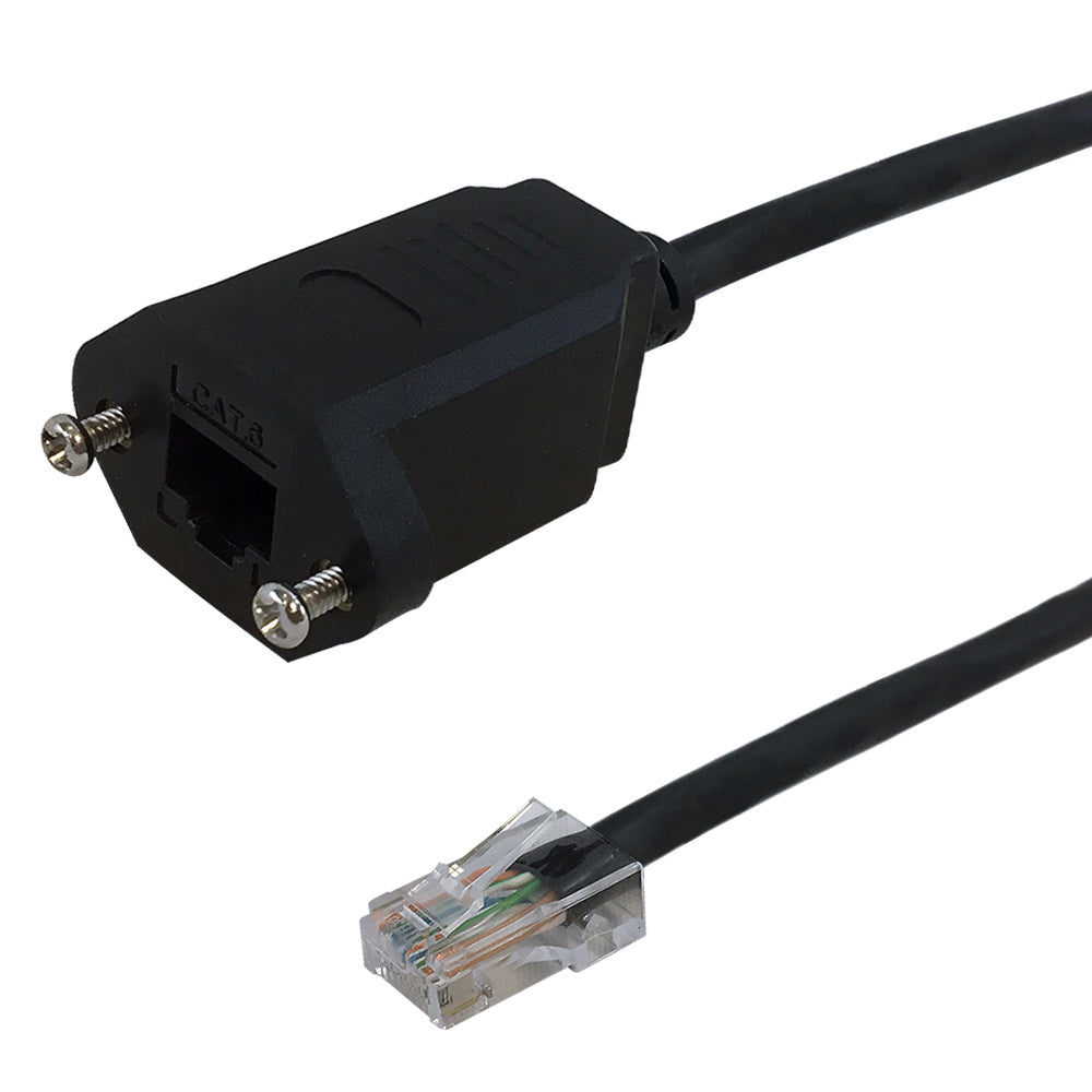

I bought a Kenwood TM-D710GA and need to extend the RJ-45 cables for the mic and operation panel going to the TX/RX unit.
I want to get this extension:
but I read somewhere that you’ll get interference if you don’t use Kenwood specific RJ-45 cables.
Is this true? Has anyone extended the mic and control panel cables successfully using generic RJ-45 cables without interference?
Haven't extended the cables, but I use a regular CAT6 between the control panel and the main radio unit. Found one on Amazon with a flat cable & a 90 degree angle on the control panel side, makes the cable a little less obtrusive. Have not noticed any problems.
Ok! I’m gonna give it a go. I’m getting the panel mount extensions as I want them flush mounted to the dash. Thank you!
