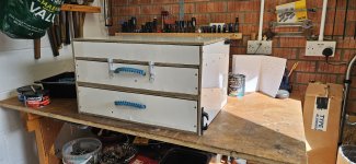

My outside dimensions were fixed by where/how I wanted it to fit -

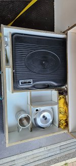

Bottom draw holds everything for a cup of tea/coffee while out (stove/kettle/2 cups/tea/coffee/sugar/spoons/spare gas)20230715_180846.jpg

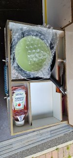

Top draw holds everything for a bacon sandwich (our meal of choice before walking/cycling) tongs/bread knife/2 plates/Frying pan/space for bread and bacon if I don't use the cooler but most importantly Ketchup for the Mrs haha.20230715_181002.jpg

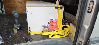

Everything inside was sized to fit my kit, the lid is held down with the strap that holds it in place, the bottom draw is kept closed in the same way. I made the paracord handles and rope fair leads keep the straps in alignment. The wood is designed for bathrooms with a gloss and matt side, it's around 10mm thick. I used the gloss side where it would require cleaning and where it slides as there are no draw runners, the top draw simply slides on a shelf between the top and bottom.
