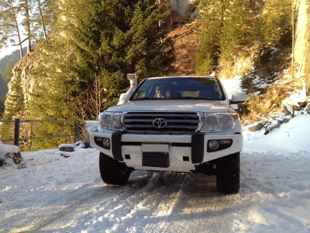

This weekend i had picked up my car again
added:
Frontbar
Winch
Mud Tyres/Rims 285/70R17
Rear Tyre Holder
Fortunately the Rearbar dont fit on a AHC equipped car, so i have the rear tyre holder, but not the weight of the additional bar.
