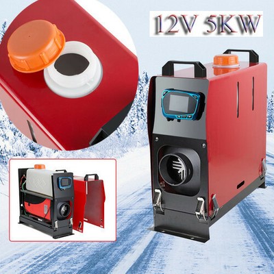

@CoExplorer, I am currently waiting on a Super Pacific pop top for my Tundra and have already bought one of the cheap Chinese Espar knock offs. They are so cheap it is just a stupid simple choice. It has a fuel cell and they are extremely efficient. I went this route with a similar Planar diesel furnace in a gasoline Transit van and it worked wonderfully with it's small fuel cell I only had to fuel about once a week (using daily).
I realize this probably isn't your answer but it is a way you could save some change for other things considering the Chinese diesel heaters are about 1/10 of Propex/Espar cost. My plan for my high altitude trips is just to bring my Honda generator and run a ceramic AC powered heater with the genny drug off in the woods on rare extreme altitude camping nights.
@86scotty Thanks for the tip. I have read about these a bit, but was planning on going Espar just for reliability/parts availability. I don't have any data to back this up, just a hunch. I am not sure I understand the fuel cell. Is this is separate fuel tank?
Yes, many of these come with their own small fuel tank. The Planar came with a 7 liter one, separate, that I mounted in a rear closet. If you didn't spill any fuel while filling there was no fuel odor at all in the van. I traveled extensively in it for about a year and a half.
The Chinese Amazon/Ebay ones that are in a metal case have basically the same small tank on top. I have not decided if I'm going to take the tank out of the case on mine and just mount the heater in the bed with the tank under the truck. To be decided.
I agree with you on reliability, the jury is certainly out on the knock off ones but they are getting very popular. For as little as I need a heater I decided to chance it. I also have an Espar in my work truck that I use about 6 months a year. I have never touched it. Never cleaned it or serviced it. It simply starts and works all night with no fuss every time it's below 50 or so. I use this truck in lower altitudes though, rarely above a few thousand feet.
Here's the cheapo I bought for the Tundra:
The pics show how the tank is mounted just below the heater in their craptastic ugly red box.

I would just recommend you do your homework before settling on something. It's a real beach to not have heat when you want it. I just looked at the B4 Espar's and I just can't get past the $2k price tag. The beauty is one fuel source of course. You can carefully set the draw tube in your vehicle's tank so that it will not draw when you have less than 1/4 tank or whatever you desire. This is how dedicated generators on RVs and other vehicles are plumbed, so with that running out of fuel is never an issue. Also, I do not know how efficient the B's are compared to the D's but the diesel ones are efficient like nothing else on out there. They will use about 16 oz. of diesel overnight running on high. If that is not accurate it's not far off. I really did run mine all night every night for about a week on 7 liters of fuel. Unfathomable efficiency when considering a gallon of diesel is $2.50. The truck my Espar is in has 250 gallons onboard so I never notice it.
