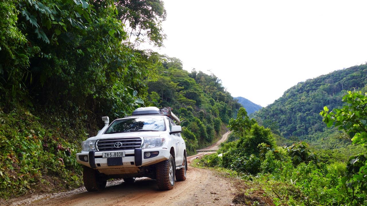

Using a modern verhicle for overlanding - many will speak against. At least when you start travelling the world.
I did the same, using a Landcruiser 200, Supercharged V8, 4.5 Liter Diesel, 14 Airbags, Satnaviation with HDD, ESP, and pretty much eletric stuff. Bought new at 2011, buildup at 2012.
And did live over an year in the vehicle till today. It has just 2 Seats now, a fridge, freezer, watertank and bed in the rear. Just a sleeper, everything has to be done outside.
2012/13 - Transafrica over the West (Zurich to Capetown over France, Marocco, Mali, Nigeria, Congo, Angola)
2014 Island
2015 Southamerica
2017-2020 Travelling in Europe (sometimes 2 Months a year, sometimes just Weekend tours)
Have add 110`000km (68350.83 Miles) - and always did love the comfort of a modern and capable Travelling-Cruiser.
For shure, the Maintenance and Repair Bills could go higher with a modern car, when electronic stuff start to go wrong or need replaced. That can happen, but not "have to" happen.
I wish you good travels - on trails or whereever your plans lead you
