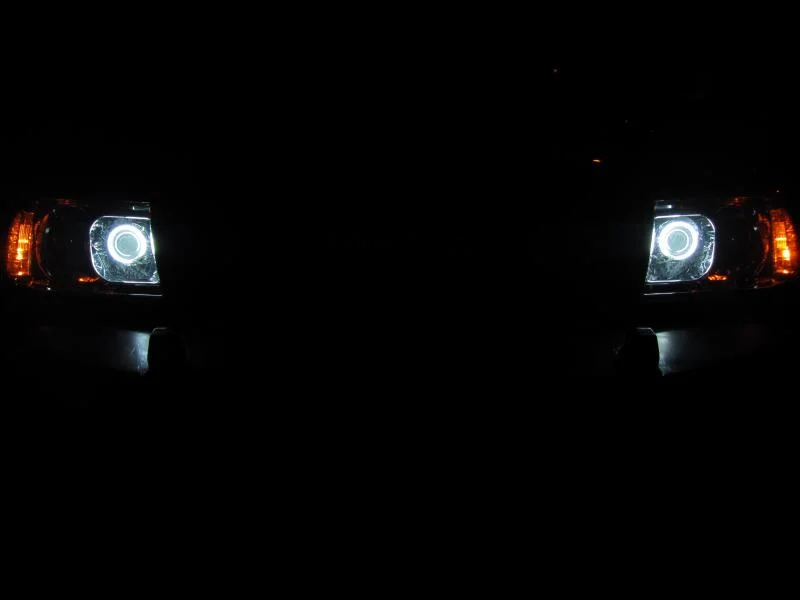

So I finally got around to doing the HID conversion to my hella fog lights. I decided that I do not want those funky switches that clutter the interior. I have a plan for the four fog lights to be powered by the two original wires that connect to the oem fog lights. Not sure about ARB, but I know that this upgrade would be good for those who run the slee and BIOR bumper because they scrap the oem fog lights and you can use the oem wiring to power new fog lights. I did not ground the wire that allows the fogs to be run along with the hi beams but I will address that issue later. I finished two fog lights today and I ordered another harness so I can add the other two next week when I do my projector retrofit:D

Night time pics to be added

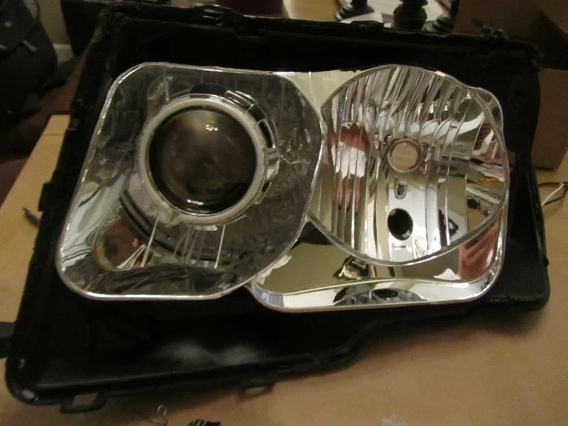

06 headlight, soon to be quad xenon! This is a retrofit project
going a little luxury here by adding the e46 shroud to the low beam location haha writeup coming soon

I did not want to have this kind of mess...so I spent an hour organizing and running the wires lol
The harness that I used from TRS requires one 9006 input to power two HID kits...therefore I used two harnesses and control 4 HID kits:D
