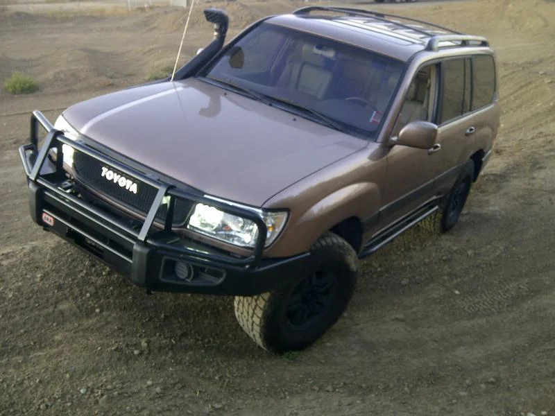

The ARB is now installed. I decided to wire the turn signals as well. The ARB has a park light and amber turn signal. Decided I want the dual filament effect so I put some amber LED's in the park light housing so I can have amber park light(like the oem turn signal) and have the amber turn signal flash when I turn.
Also installed some bilsteins on the front end, best comfort upgrade to date! They improve handling by a longshot! Wish I did this earlier

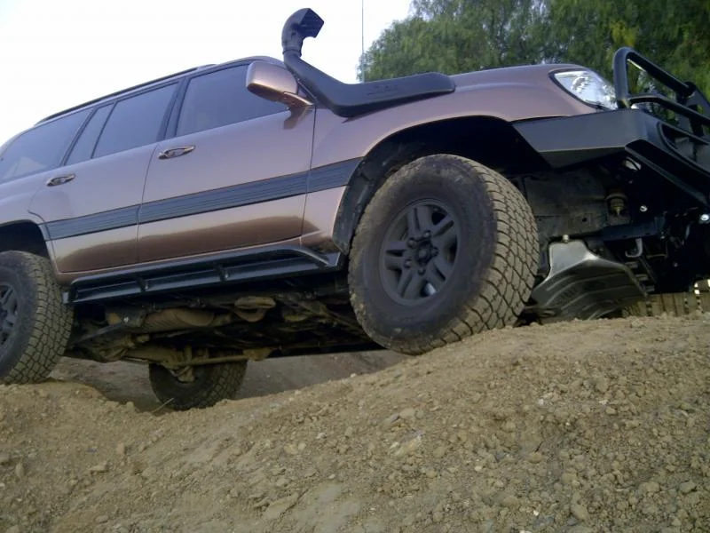

Some offroading(pre-bilstein and pre-arb wiring)..not too serious

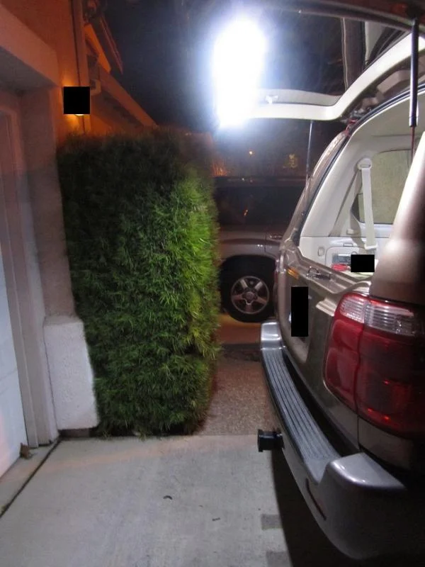

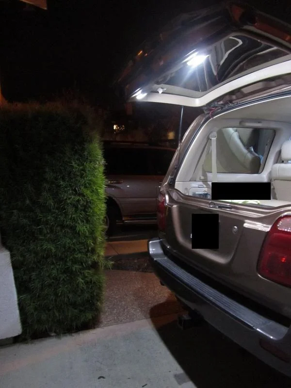

I will be adding camping lights to the hatch for the 100 series, write up coming soon! Tired of loading up the trailer at night and not having enough light when hitching up or removing the trailer

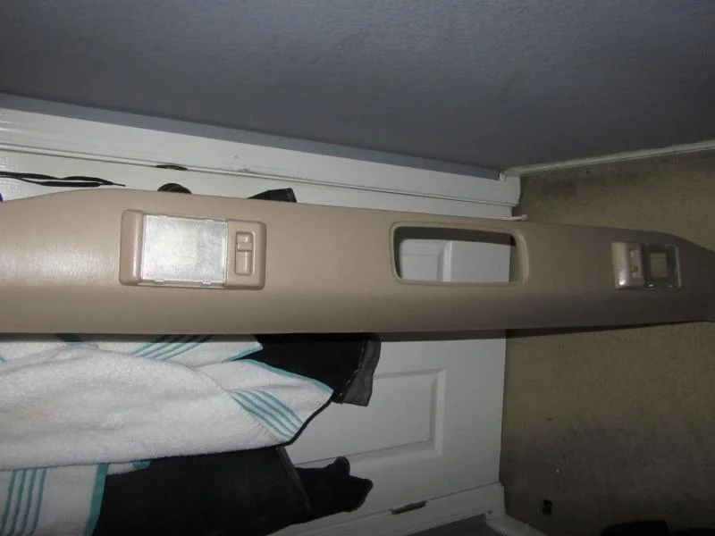

Camping lights, done! Added two 80 series dome light panels to the rear hatch! Perfect setup with 7.5A inline fuse and hidden wiring for a factory look along with some LED panels in the dome light housings
Should I try red LEDs instead?
attachment.php
attachment.php
Nice mod. Install details? Cut and mount in plastic, splice into existing wires or new wirimg with a switch?
