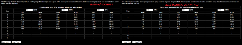

With 3.9 diffs, your top speed in your lowest gear (6.93) with 395 tires at 2400 rpm will be 12mph. Idle speed will be 3.5mph.

Certainly a lot to think about in there. I don't have any intention of driving over 70mph in the truck, and the goal of EcoHubs is to cruise at 60mph up/down minor to moderate hills with significantly reduced driveshaft RPM.
Most of my reasons why EcoHubs vs 3.07 come down to cost: at 200% the cost for a 14% performance difference, I can use the funds to enhance other parts of the build. I can also easily reverse EcoHubs in my driveway in ~2hrs; I've kept the original spider gears, labeled, and cellophane wrapped on a shelf if I want to move to 3.07 and 14R20 in the future.
That transfer case costs more than I paid for the entire truck, running, including the cost of fuel to drive it 1200mi home :ROFLMAO: I'll accept one as a donation though.

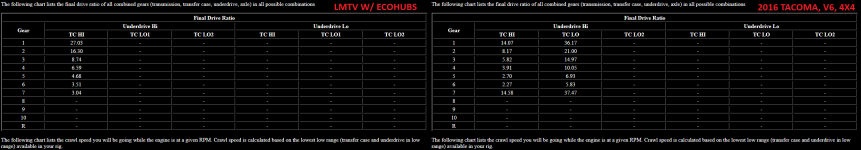

With 1st gear @ 6.93 and 3.9 in the diffs w/ EcoHubs my final drive ratios will be somewhere in the middle of a 3rd gen Tacoma between 4H and 4L. With the truck launching in 2nd gear in "D" using 2-7, it is similar to the final drive ratios of a Tacoma using 1-6 in 4HI.
My lowest "crawl speed" will be as you say, around 4mph, but I'm not sure the torque converter locks up before 3rd gear. Also, I can use the brakes. I'm planning on expanding my wet tank to be a bank of 3 tanks which should allow me to ride the brakes for a little bit. And if I ride them too long/deplete air, the airbrakes will slow the truck down more as I lose pressure. The LMTV has a considerable CFM output from the engine driven compressor though, higher than most stock compressors.
