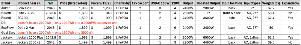

Have been doing some tech specs comparisons online... any other brands that I should be looking at?
Having trouble figuring out what the solar panel input connection types are.
