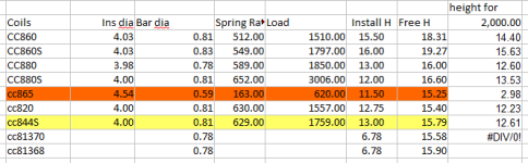

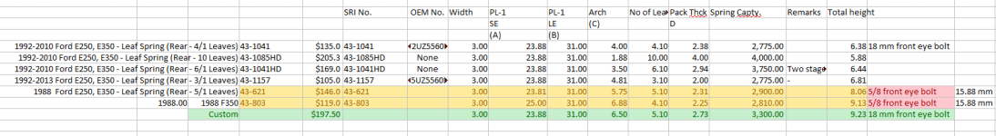

Some info I've collected on springs over time. I was looking for 4x4 vans but some info may be useful to you.
MOOG coil springs.
Leaf Springs
